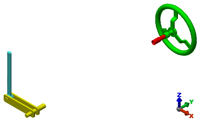

  6. Click Yes when prompted about importing CAD part names. The model opens in the FEA Editor environment, as shown below.
