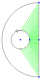

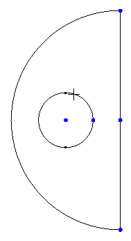

    To create a 16x16 mesh between the small right arc and the straight line...

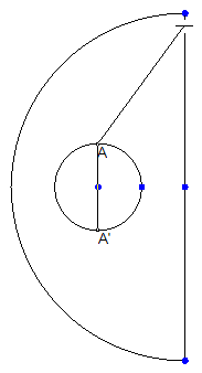

    1. Type 16 in the AA' field and type 16 in the AB field. This sets the divisions along the selected sketch objects and along the distance between the two objects.
    2. Click near the top of the right small arc as shown in the following image.
    3. Click near the top of the line.

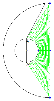

    4. Click Apply.
    5. To create a 16x16 mesh between the two left arcs...
    6. Click near the top of the left small arc.
    7. Click near the top of the large arc.
    8. Click Apply.
    9. Press Esc to exit the Between 2 Objects mesh command.

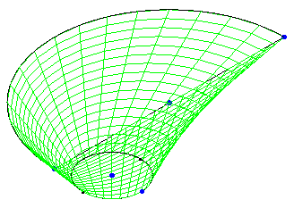

  2. Click  View Navigate Orientation Isometric View.
    The model displays as shown in the following image.
