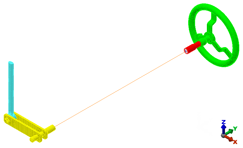

Next, divide the beam element (Part 5) into smaller increments to provide multiple results calculation points along its length.
The model should look like the following image:
This tutorial is now complete. You can use the meshed model to complete the Remote Crank Static Stress Analysis tutorial.
