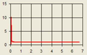

    4.  Type 15 in the Oscillating Frequency (Hz) field.
      • Type 0.05 in the Damping Ratio (0.01 = 1%) field.
      • Type 1 in the Scale Factor field. The Period and Displacement table values are automatically populated, and the spectrum graph looks like the image below.
