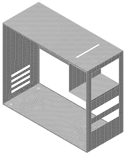

    3. Click the Mesh model button.  The meshing process starts.
  2. When asked to review the mesh results,  click No.  The meshed model displays as shown in the following image.
  3. Use the View Navigate Orbit Orbit, View Navigate Zoom Zoom, and/or  View Navigate Pan commands to inspect the mesh in various areas of the model.
