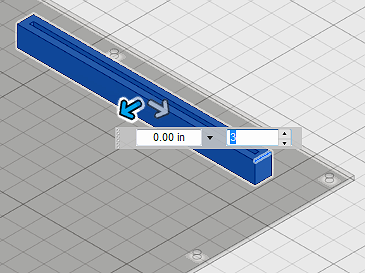

Rectangular Pattern. Note that the Objects field in the RECTANGULAR PATTERN dialog box indicates that 1 object is selected. - Click the Directions button in the RECTANGULAR PATTERN dialog box.
- Click one of the short edges of the edge connector to indicate the pattern direction. Two direction arrows appear near a corner of the edge connector, as shown in the following image:
- Click and drag the Y-direction arrow towards the opposite side of the circuit board. Note that the pattern defaults to three items in this direction, which must change to four after specifying the pattern distance.
- Type 3.75 in the distance field.
- Press Tab to jump to the number of objects field and type 4.
- Press Enter (or click OK) to complete the Rectangular Pattern command. Since we did not grab the X-direction arrow or specify a distance in that direction, the pattern is created in a single direction. Note that three more instances of the Edge Connector part have been added to the browser.

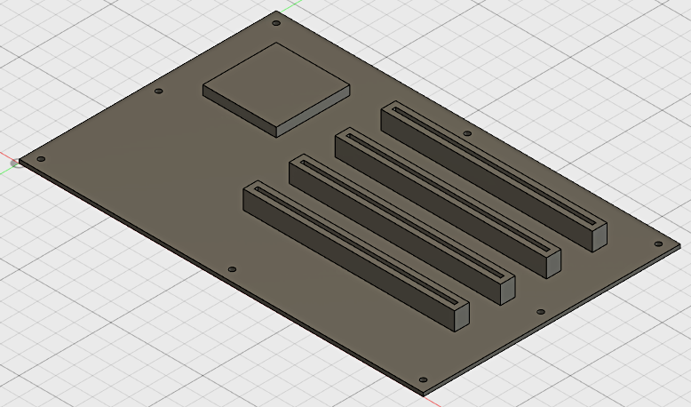

- Click the Activate Model radio button to the right of the Circuit Board heading at the top of the browser. With the assembly active, none of the parts will be displayed using transparency.
- Click in the display canvas background to clear the current selection.
- In the QAT, click
Save. This completes the construction of the Circuit Board model. The model appears as shown below.
