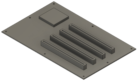

Using SimStudio Tools, we will construct a circuit board assembly to use in the following subsequent tutorials:
If you chose not to install the SimStudio Tools application, a completed CAD model is included within the tutorial models archive. This model can be used as the input file for the subsequent meshing tutorial.
