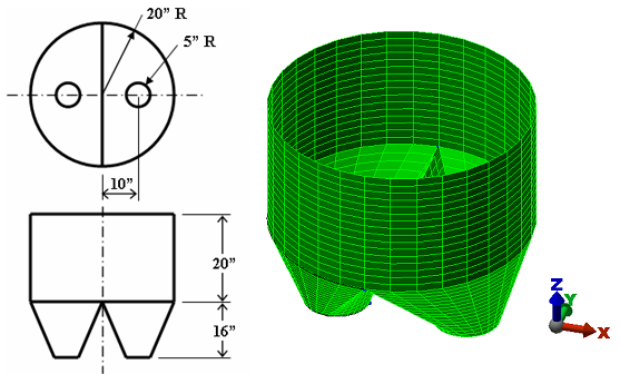

- Construct one of the two conic portions of the 3-D hopper shown in the following image.
- Extrude the lines around the top arc to form half of the cylindrical section. Use the Move or Copy command with the Copy and Join options enabled to do so.
- Use the Mirror command to create the other half of the model.
