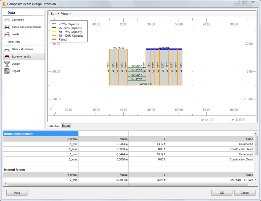

Use the Extreme results tab to review extreme values of internal forces for a beam selected in the viewer.
The extreme results to review include:
- Beam displacement
- Internal forces
- Reactions.
For each of these extreme results the following data displays:
- Maximum and minimum values
- Load case or load combination
- For beam displacement: x coordinate indicating where beam displacement occurs
- For internal forces: x coordinate indicating where internal force are acting
- For reactions: node id where min/max value occurs.
Sign convention (positive directions of forces and moments)
