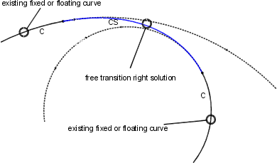

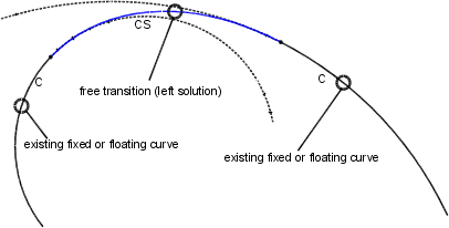

The following illustrations show a free transition between two curves. The solution depends on the selection order of the curve that the transition is being attached to. The first illustration shows a left solution, where the inner circle was selected first. The second illustration shows a right solution, where the inner circle was selected second:
Find. The current transition definition is displayed on the command line. For more information about changing the default transition definition, see To Work With Curve and transition Settings for Alignments.
The solution depends on the order in which you select the curves that the transition is being attached to. For a solution where the transition is coming from the left, select the inner circle first. For a solution where the transition is coming from right, select the inner circle second.

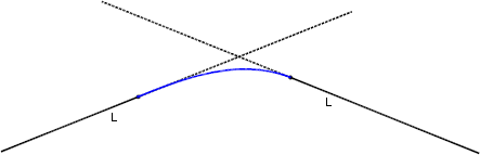

Add a free transition between two lines in situations where you want the transitions to maintain tangency to the lines they are attached to. For this solution, the transitions are simple, incurve, or outcurve.
The following illustration shows a free transition between two lines. The possible solutions include:
Find. The current transition definition is displayed at the command line. For more information about changing the default transition definition, see To Work With Curve and transition Settings for Alignments.

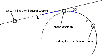

Add a free transition between a line and curve in situations where you want the transition to maintain the radius of the curve it is attached to, even if the curve is edited. For this solution, the transitions are simple because the radius of the transition at the line end is infinite (as opposed to a compound transition, where the radius at each end is finite). This solution between a line and a curve is valid for all transition types because all transitions types support the simple transition.
The two possible solutions depend on which element you select first, either the line or the curve.
The following illustration shows a free transition between a line and a curve, where the line was selected first:
