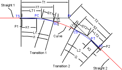

The following illustration shows the various parameters of a transition:
Transition Parameter Description
i1 The central angle of transition curve L1, which is the transition angle.
i2 The central angle of transition curve L2, which is the transition angle.
T1 The total straight distance from IP to TS.
T2 The total straight distance from IP to ST.
X1 The straight distance at TC from TS.
X2 The straight distance at CS from ST.
Y1 The straight offset distance at TC from TS.
Y2 The straight offset distance at CS from ST.
P1 The offset of the initial straight into the PC of the shifted curve.
P2 The offset of the initial straight out to the TP of the shifted curve.
K1 The abscissa of the shifted PC referred to the TS.
K2 The abscissa of the shifted TP referred to the ST.
LT1 The long straight transition in.
LT2 The long straight transition out.
ST1 The short straight transition in.
ST2 The short straight transition out.
