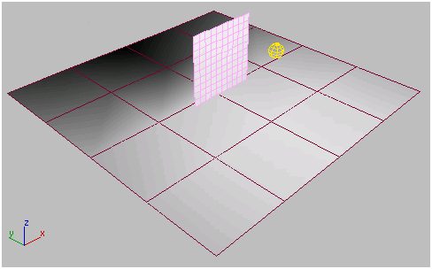

In order to create the lighting of a scene, 3ds Max calculates the intensity for discrete points in the environment by subdividing the original surfaces into elements which are part of a radiosity mesh. This rollout allows you to determine whether you want a mesh or not, and to specify the size of the mesh elements in world units. For quick tests, you might want to turn off the mesh globally. The scene will look flat, but the solution will still give you a quick impression of the overall brightness.
The finer the mesh resolution is, the more accurate the lighting detail will be. But there is a trade-off in time and memory.

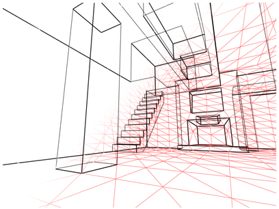

Meshing (shown in light red) subdivides flat surfaces in the scene.

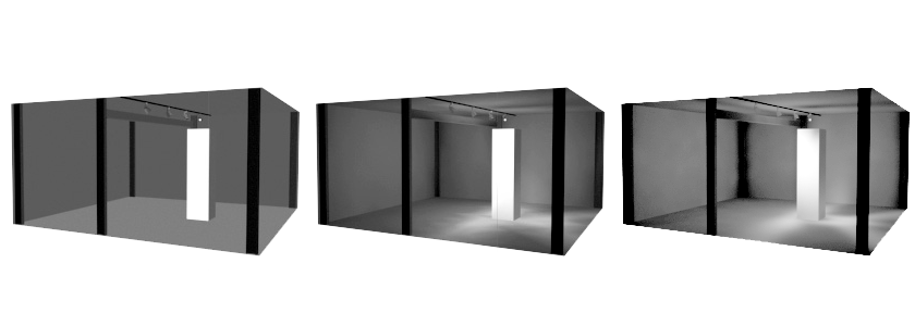

Left: No mesh. The solution looks very flat.
Middle: Coarse mesh, every 24 inches. The lighting improves.
Right: Fine mesh, every 4 inches. The lighting reveals more subtle effects.

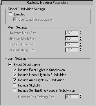

Global Subdivision Settings group
- Enabled
- Turns on the radiosity mesh for the entire scene. Turn off the mesh when you want to perform quick tests.

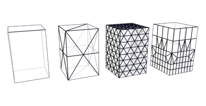

Left: A simple box with no subdivision
Middle Left: The box faces are subdivided
Middle Right: The box faces are subdivided with a smaller Meshing Size
Right: The box faces are subdivided with Adaptive Subdivision

Adaptive Subdivision using the default mesh and light settings

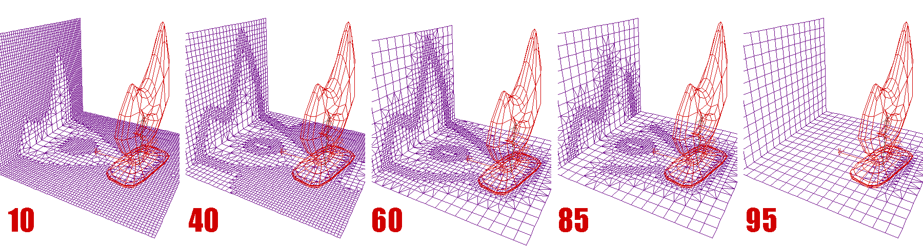

- Faces that have vertex illuminations that differ by more than the Contrast Threshold settings are subdivided. Default=75.0.
Radiosity solutions with different Contrast Threshold values. The best solution is at the center, with Contrast Threshold=60.

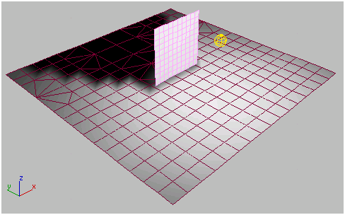

Adaptive Subdivision with light settings turned off
Note: Lighting from lights that are not included while shooting direct light are calculated using random sampling. These lights also are not able to affect the adaptive subdivision of objects.
