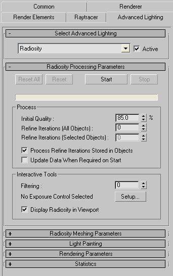

Radiosity to display the Advanced Lighting panel with Radiosity chosen as the advanced lighting type. The rollouts for radiosity are displayed.
- Choose Rendering
Radiosity to display the Radiosity panel.
- On the Radiosity Processing Parameters rollout, click Start to begin processing radiosity.

Advanced Lighting to display the Advanced Lighting panel. On the Select Advanced Lighting rollout, choose Radiosity as the advanced lighting type. The rollouts for radiosity are displayed.
- Choose Rendering
Advanced Lighting
- On the Radiosity Processing rollout, under Interactive Tools, click Setup to display the Environment panel where you set exposure controls.
