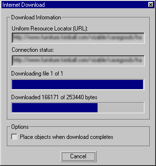

Internet Download Dialog
When you drag geometry files from the World Wide Web using the Asset Browser, the Internet Download dialog appears. How long this dialog remains on-screen depends on the size of the file you're downloading.
Interface
Download Information group
Displays the URL of the download, the pathname of the file being saved, and a meter indicating the bytes downloaded.
Uniform Resource Locator (URL)
Displays the URL and file name that you're downloading.
Saved as Local File
Displays the pathname of the file being saved as a result of the download.
Options group
Specifies whether or not to place the objects when the download is complete. If you leave this option selected, 3ds Max allows you to position the mouse at the location of your choice.
