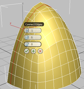

Subdivide the seam and rim faces to extrude:
3ds Max selects all edges parallel to the first one, in a ring around the object.
3ds Max draws a single loop of edges around the selected edges. It also displays the “caddy” controls for the Connect tool.
(When you Shift+click certain tools on the ribbon, 3ds Max displays the caddy controls for that tool.)

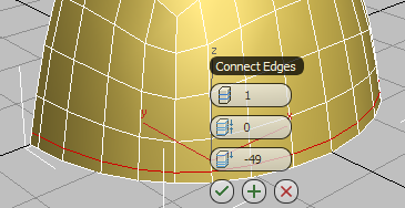

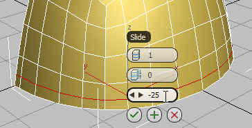

By default, the loop is placed in the center of the selected edges, but the negative Slide value you will specify in the next step will position it to the left of center.
Edge slides to the left

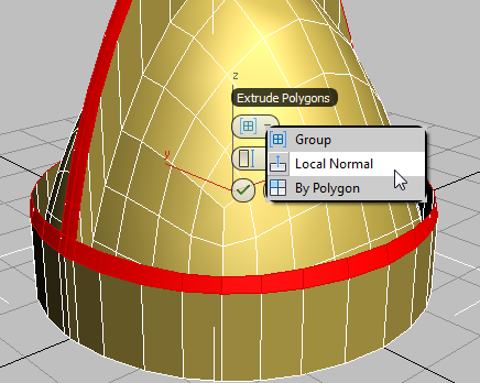

Extrude the helmet seam and rim:
3ds Max displays the caddy controls for the Extrude tool.
