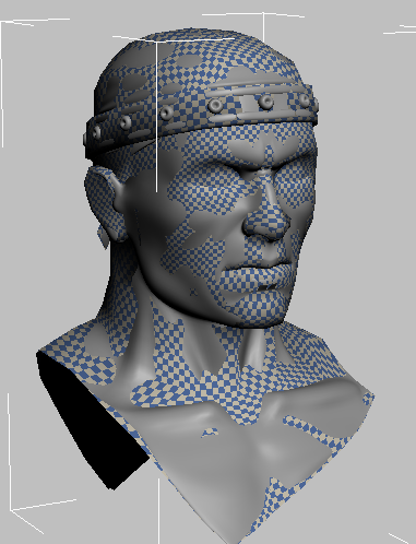

The only visible object is an editable mesh model of the head of a warrior. This is the low-resolution target object, consisting of roughly 750 polygons, to which you will apply normal bump maps. Its surface is smooth, and it has a checkered texture map applied to it. This checker map was used as a visual guide in setting up the texture mapping of the surface. An Unwrap UVW modifier has already been applied.

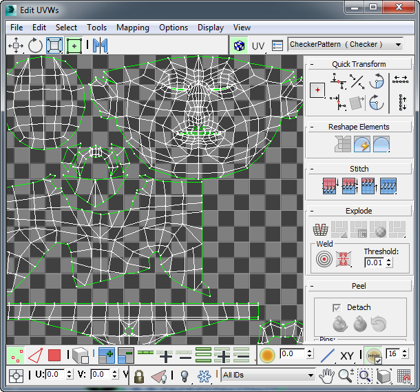

Edit UVs rollout, and click the Open UV Editor button.
3ds Max opens the Edit UVWs dialog, which shows how the Unwrap UVW modifier has already been applied to the target object, and how the texture coordinates have been mapped to the surfaces of the model. This layout was designed to facilitate painting, which can be necessary for “touching up” texture mapping.

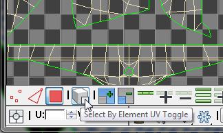

(Polygon) to make the Polygon (Face) sub-object level active, then click to turn on
(Select By Element UV Toggle).
In the main Edit UVWs window, select geometry elements to see how they correspond to the model in the Perspective viewport.
Close the dialog when you are done.

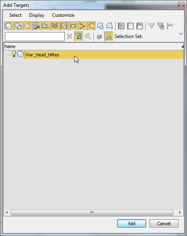

In order to extract the high-resolution information from the source model, you will now need to merge it with the low-resolution version.
Merge the high-resolution model:

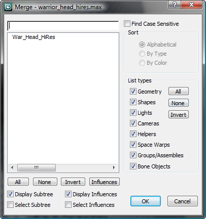

Merge, and on the file dialog, navigate to the folder that contains your scene files. Select the scene that contains the high-resolution model, warrior_headhires.max, then click Open. 3ds Max opens a Merge dialog.

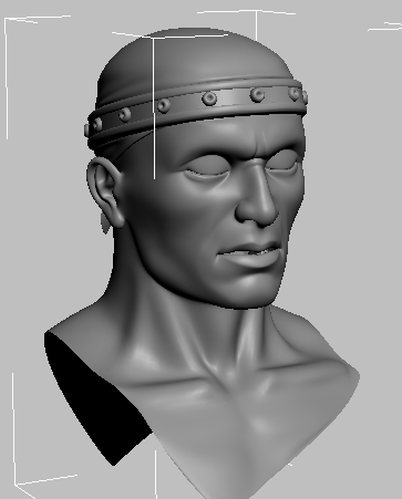

The two models are now visible. Both are the same size and are precisely aligned.
This model, at approximately 96,000 polygons, shows a much greater amount of detail.

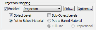

Projection Mapping group, turn on Enabled, then turn off Sub-Object Levels, since no sub-selections exist in this particular model.
The drop-down list in the Projection Mapping group has changed from (No Projection Modifier) to Projection, indicating that a new Projection modifier has been placed on the stack for War_Head_HiRes.

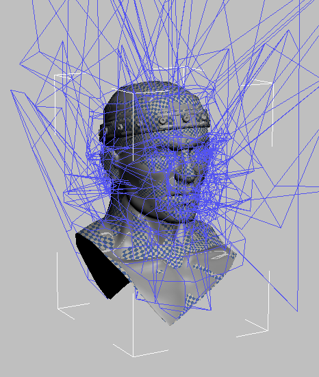

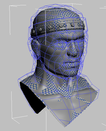

Also, a rough wireframe cage appears around the high-resolution head object in the viewport. The cage shows a considerable amount of irregular geometry, but this is usual when it is first applied. The problem is easy to correct.
Cage rollout, click Reset.
The cage resets itself to fit tightly around the target low-resolution model.
The shape of the cage is correct, but it is important that the cage fully encompass the source high-resolution model. Where the source geometry lies outside the cage, the result will be ray intersection misses, which in turn will cause flaws in the normal bump map.
Push group, set Amount to 1.1.
After the value is applied, it resets to 0.0 and the cage balloons outward slightly so that the entire War_Head_HiRes object, with all its bumps and protrusions, fits within it.

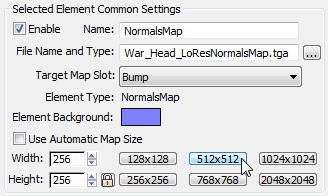

Target Map Slot drop-down list, choose Bump, then click the 512 x 512 Width/Height button, which sets the output size to 512 by 512 pixels.
At this point, you have defined all the basic elements and settings for generating a normal bump map.

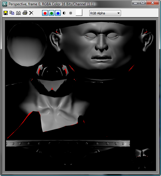

The rendered frame shows the unwrapped Diffuse map of the high-resolution model. Assorted red patches are visible, indicating where the bump map projection rays did not properly capture the underlying geometry. This is because the cage created by the Projection modifier did not completely cover the high-resolution model in these spots.
This would create problems if you applied the normal bump map to the low-resolution target. You will resolve this problem by applying neutral normal values to these red patches so they blend with their surrounding areas.
Objects To Bake

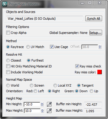

Projection Mapping group, click Options to display the Projection Options dialog.
With Ray Miss Check turned off, the red patches in the rendered normal bump map will be replaced by a neutral black background with a normal value of 0, a value that will permit the regions to blend effectively with the normal map that will be created.
Click Overwrite Files when you are prompted to overwrite the previously rendered file.
The rendered Diffuse map shows that the previous ray misses now appear as black, the neutral element background.

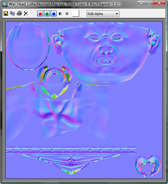

At the same time it renders the Diffuse map, 3ds Max renders the Normal Bump map as a TGA image. Now you will take a look at this image to see the blending result.
View Image File. In the file dialog that displays, navigate to the image file location, which by default is
\sceneassets\images.
The blue channel conveys vertical depth information, and the red and green channels enhance this information by providing a direction vector for the normal orientation of the surface at each point. This conveys more information than an ordinary grayscale bump map.
