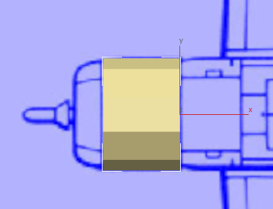

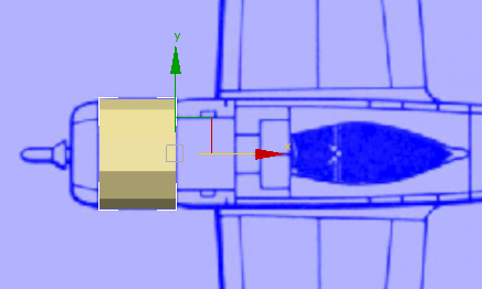

  4. Activate (Select And Move). In the Left viewport, move the cylinder so it is well centered on the image of the airplane. In the Top viewport, move it forward so its rear edge coincides with the rear edge of the engine cowl.
    Note: As you create the model, it can help to zoom and pan a particular viewport to get a better view of the geometry and the blueprint image. In general, we mention view changes when they are particularly important or useful, but you might want to change the view more often than we indicate. This is quite all right.
  5. If you need to, reduce the height of the cylinder so its front edge matches the edge where the air-intake cover meets the cowl.

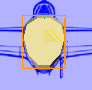

  6. Go to the Modify panel, and apply an FFD 3x3x3 modifier to the cylinder.
    FFD stands for “free-form deformation.” This modifier lets you adjust the shape of the cylinder, using a 3x3x3 array of control points.
  7. On the modifier stack, click (the plus-sign icon) to open the FFD 3x3x3 modifier hierachy. Click Control Points to highlight that sub-object level.
  8. In the Left viewport, drag to select the bottom row of FFD control points (this actually selects all nine control points at the bottom of the lattice), then move them down so they coincide with the bottom of the fuselage. Scale them along the X axis so they are a bit closer together.
  9. Drag to select the upper row and plane of control points. Scale them out a bit along the X axis, then move them up a bit along the Y axis.
    You now have a good cross-section of the cowl at the front of the fuselage. In the next procedure, you refine its shape along the length of the airplane.

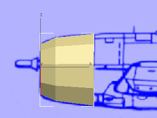

  1. On the modifier stack, click the FFD 3x3x3 entry to exit the Control Points level. Then choose Modifier List FFD 2x2x2.
    You will use this additional free-form deformation modifier to give some taper to the nose of the airplane.

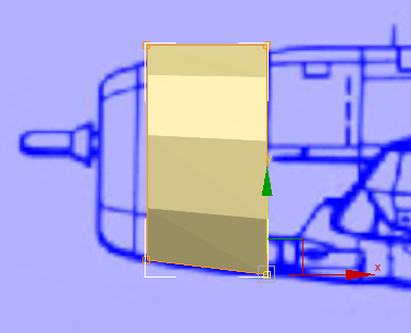

  2. On the modifier stack, click (the plus-sign icon) to open the FFD 2x2x2 modifier hierachy. Click Control Points to highlight that sub-object level.

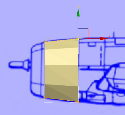

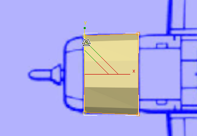

  3. In the Front viewport, drag a selection box to select the row of control points at the lower leading edge of the cowl, then move the points to follow the taper of the image. Do the same for the lower trailing edge of the cowl.
  4. Do a similar adjustment for the upper profile of the cowl.
  5. In the Top viewport, drag to select the leading plane of control points, then scale them down a bit along the Y axis to taper the cowl in that dimension as well. so it matches the blueprint image.
    The changes you make in the Front and Top viewports also appear in the Left viewport.

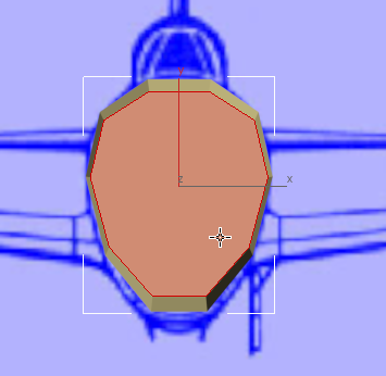

  4. On the ribbon Modeling tab Polygon Modeling panel, click (Polygon) to go to the Polygon sub-object level.
  5. In the Left viewport, click to select the large polygon at the front of the cowl.
