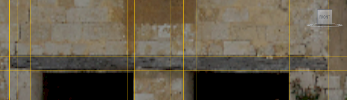

Correct the outline of the lintel beam:
  1. Click the Front face of the ViewCube to return to a Front view.
  2. Pan and Zoom to get a good view of the faces that show the lintel beam.
    As you can see in the bitmap, the lintel has an irregular outline. You will edit the faces so they correspond to the outline of the wooden beam.
  3. On the ribbon, click (Vertex) to go to the Vertex sub-object level.
  4. At the left end of the lintel, move the three lower vertices along the Y axis so they follow the outline of the beam.
    Tip: To do these edits and the ones that follow, it might help to zoom in more closely, then pan as you work on other parts of the lintel.

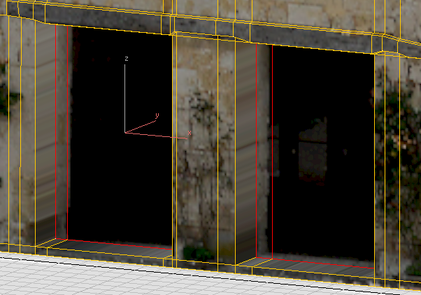

  5. Where the lintel passes over the central pillar between the two doorways, click to turn on (Swift Loop), then add a new vertical loop where the stones of the pillar form an angle into the beam.
    This new loop of edges is so you can add a vertex at the angle point without creating a free-standing vertex. Free-standing vertices are never a good idea.
  6. Right-click to close the Swift Loop tool.
  7. On the ribbon Edit panel, click to turn on (Cut).
  8. Use the Cut tool to draw new edges that follow the top of the pillar and the bottom of the beam.
    Tip: The cursor for the Cut tool has three different forms:
    • when the cursor is at a vertex
    • when the cursor is on an edge
    • when the cursor is on a face
    To avoid creating free-standing vertices, do not click the mouse while the cursor shows that it is on a face.
  9. Right-click to close the Cut tool.
  10. At the right end of the lintel, click to turn on (Swift Loop), then add two new vertical loops where the stones rise into the beam.
  11. Right-click to close the Swift Loop tool.
  12. Click to turn on (Cut).
  13. Cut new edges to follow the outline of the beam.
  14. Right-click to close the Cut tool.
  15. Vertically move the two upper vertices at the right end of the beam, to better follow the beam contour.
  16. Click to activate (Select Object) and deactivate Move.
Now the faces over the lintel are a fair approximation of the shape of the beam.

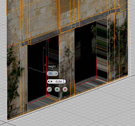

Add depth to the doors:
  1. Zoom, pan, and orbit (or use the ViewCube) to get a better view of the doorways.
  2. Click and Ctrl+click to select the doorway faces. Include the portion with stone to the left of each door. (The left-hand doorway has an extra sliver of face that the right-hand doorway does not have.)
  3. On the ribbon, Shift+click (Extrude), then use the caddy’s Height field to extrude the doorways inward by a value of –0.6m.
  4. Click (OK) to accept the extrusion.
  5. Orbit (or use the ViewCube) to see the doorways from the other side.
  6. On the ribbon, click (Edge) to activate the Edge sub-object level.
  7. Click and Ctrl+click to select the four vertical edges that are part of the doorways, but whose faces show stonework.
  8. Move these edges to the right along the X-axis until the faces show only the shadows beyond the door.
    Incidentally, the perspective captured by the camera helps with the texture projection onto the left-hand doorjambs: These now look good. The right-hand doorjambs don’t look as good. This is a problem that you will fix in a later lesson.
  9. Click (Edge) to exit the Edge sub-object level.
