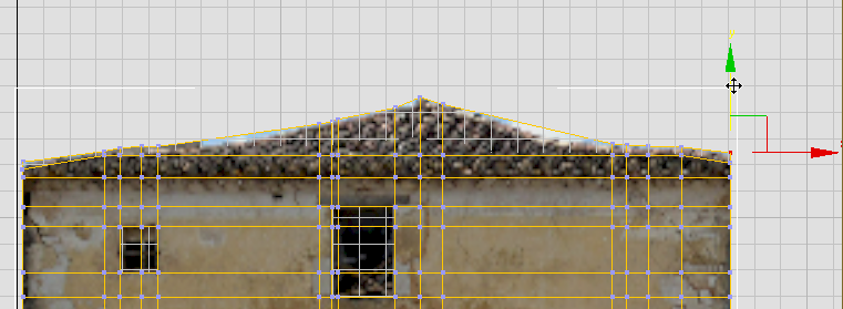

    On the ribbon, click (Vertex) to activate Vertex sub-object mode.
  8. One at a time, move vertices at the rear roofline down vertically to match the bitmap of the roof.
    Tip: At the extreme left and right of the roof, you might also want to move the front roofline vertices slightly downward.
    After moving all existing vertices, you can see there are two areas on either side of the peak, where the sagging of the medieval roof still shows some sky.
  9. On the ribbon Edit panel, turn on (Swift Loop), then in the viewport, add two vertical edge loops. Each loop should be near the middle of the sky area, on either side of the peak of the roof.
  10. Right-click to close Swift Loop.
  11. Move the new vertices at the rear roofline down vertically to hide the sky-blue (or cloudy) areas of the façade texture.
  12. Click (Vertex) to exit the Vertex sub-object level.
