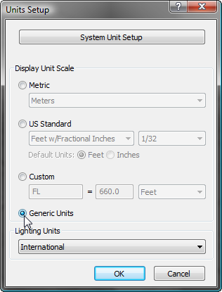

  2. From the Customize menu, choose Units Setup, and in the Units Setup dialog Display Unit Scale group, make sure Generic Units is chosen.

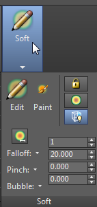

  1. On the ribbon Polygon Modeling panel, click (Soft Selection) to turn it on.
    When Soft Selection is active, 3ds Max displays the Soft Selection controls on a temporary panel named "Soft" to the right of the existing ribbon controls. If there's not enough room on the ribbon for all of the controls, the panel shows only its title, and you need to click the panel to open its controls.
  2. On the Soft Selection panel, set Falloff to 30.0.
