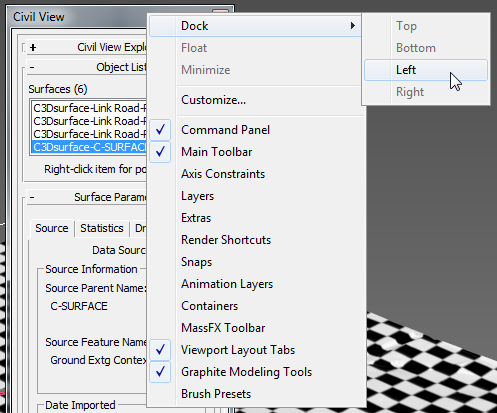

Open the Civil View Explorer:
select the checkered ground plane, C3Dsurface-C-SURFACE-GroundExtgContext.

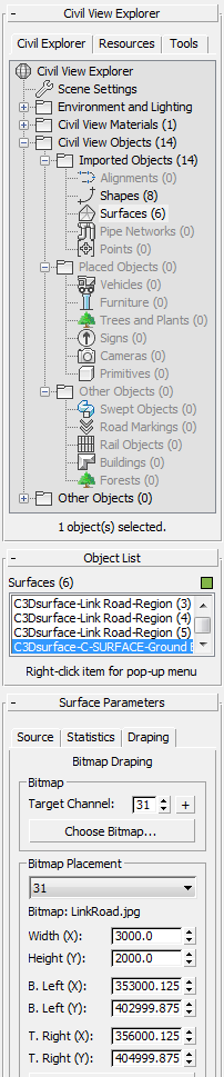

Civil View Explorer. 3ds Max opens the Civil View Explorer, which is a tall panel that gives you access to most Civil View features.
The upper part of the Explorer, the Civil View Explorer rollout, gives an overview of the scene environment, objects in the scene, and other resources. The lower part of the explorer is context sensitive, and shows controls for objects that are currently selected.
Left. This is convenient if you are going to be working with Civil View for a length of time.

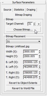

The Draping tab has controls for applying a bitmap to a surface.
It also has controls for placing the bitmap, but in this case bitmap placement is provided by a file named linkroad.jgw. This is known as a world file. The world file must have the same name as the bitmap ( linkroad.jpg), and a file name extension that matches the bitmap type: For a JPG file, the world file name extension is JGW. A world file contains text-based coordinates, and typically it is provided by the creator of the aerial image.
Bitmap group, click Choose Bitmap.
3ds Max opens a file dialog.
This bitmap is an aerial image of a portion of countryside.

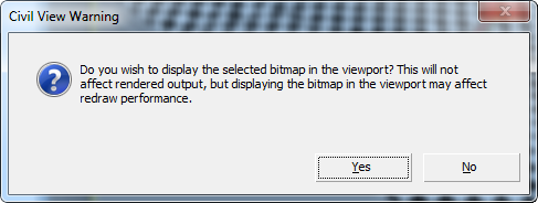

3ds Max asks if you want to display the bitmap in viewports.
Now the image appears on the ground plane, putting the roadway in context.
