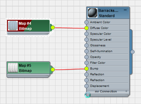

Bump mapping uses intensities in the map to affect the surface of the material when you render it: White areas appear higher, and black areas appear lower. This is why the bitmap you use for bump mapping is often a black-and-white version of the map you use for texture.
- Wire the node to the Bump component of the BarracksWalls material.
As it did for the other Bitmap nodes, 3ds Max adds a Controller node for the bump map’s Value.
Tip: Pressing L tells the Slate Material Editor to lay out nodes in the active View.

- Wire the new Bitmap node to the Bump component of the BarracksRoof node.
- Double-click the new Bitmap node to display its parameters. On the Coordinates rollout, change the W Angle to 90.0 to match the texture.
- Double-click the BarracksRoof material node. On the Maps rollout, increase the Bump Amount to 90.

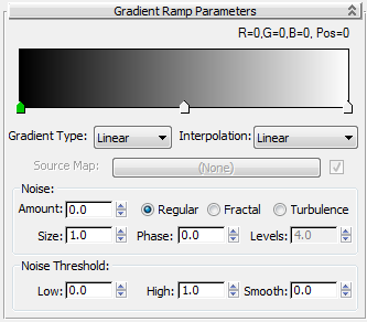

- In the Slate Material Editor, drag a new Standard material node to the active View, double-click the node, and name the new material SentryBar.
- From the Material/Map Browser
Maps
Standard group, drag a Gradient Ramp node into the active View. Wire this node to the Diffuse Color component of the SentryBar material.
- Click the new SentryBar material node to highlight it, then click
(Assign Material To Selection) and
(Show Shaded Material In Viewport).
- Double-click the Gradient Map node to see its parameters.
Gradient Ramp is a 3D procedural material like the Noise material you used for the generator casings.

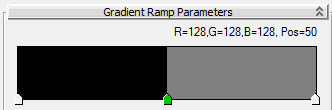

- In the Gradient Ramp Parameters rollout, change the Interpolation type to Solid.
The gradient display changes to two solid colors, one of them black.
- Double-click the arrow-shaped slider at the middle of the gradient display. This slider controls the color to its right (you could use the first slider on the left to adjust the black color.)
Gradient Ramp with solid colors
Double-click the middle slider (shown in green) to change the color to the right of the slider.
3ds Max opens a Color Selector.
- On the Color Selector, change the second gradient color to orange: Red = 255, Green = 150, Blue = 0.
- Click OK to close the Color Selector.
- On the Coordinates rollout, change the U Tiling value to 10.0.
The material changes from two color areas to multiple stripes.
- Also in the Coordinates rollout, change the W Angle value to –2.5.
Now the stripes have an angle to them.
