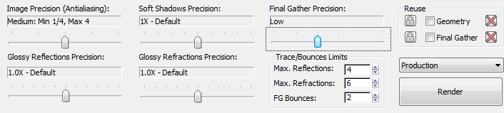

Turn on final gathering:
Final Gather causes light to bounce off surfaces as it does in real life.

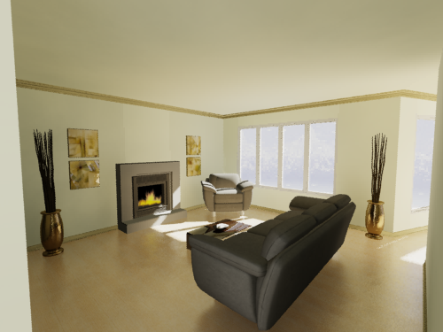

Now the room is clearly lit by daylight. It is actually a little too well lit. Also, there are some patchy areas on the ceiling and behind the couch that are caused by inaccuracies at the Low level of Final Gather. These are easy to fix.
Adjust the exposure and final gather settings:
Now the room is well and realistically lit.
(You might notice that on the Rendered Frame Window dialog, the status of Final Gather changes from “Draft” to “Custom,” because of your Render Setup change.)
