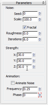

- Click the Modifier List drop-down menu and choose the Noise modifier.
- In the Noise group, turn on Fractal, and in the Strength group, set X, Y, and Z to 30.0.
The rock is taking shape, but it could be flatter.

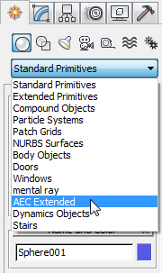

(Geometry), then from the drop-down list (at present, it shows “Standard Primitives”), choose AEC Extended.
AEC Extended objects are pre-built geometry, including railings, fences, and plants. They are a fast way to add realistic details to a scene.

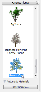

- On the Object Type rollout, click to activate Foliage.
- On the Favorite Plants rollout, choose Generic Oak as the species of tree.
- Right-click the Top viewport to activate it, and add the tree to the scene by clicking a point slightly below and to the right of the rock.

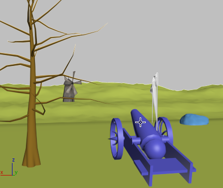

To give the scene some atmosphere, we’ll make the tree appear stunted and battle-scarred.

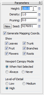

- With the tree still selected, on the Parameters rollout, set Height to 150.
- In the Show group, turn off Leaves, and in the Level-Of-Detail group, choose Low to reduce the number of branches.
- If you are not yet satisfied with the appearance of the tree, on the Parameters rollout click New.
Each time you click this button, the Seed value is changed, causing the tree to undergo a random reconfiguration.
- When you are satisfied with the appearance of the tree, rename the Foliage001 object in the Name field using the same procedure you followed for the rock. Call this object oak_tree.
