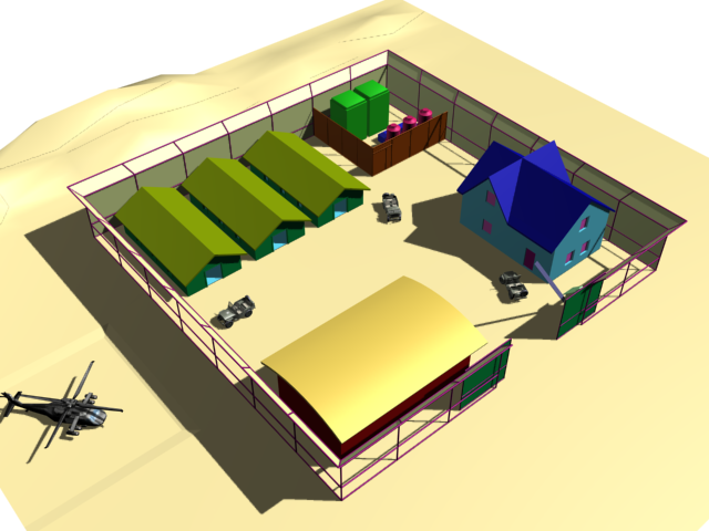

Except for the vehicles, the jeeps and helicopter, this scene contains no materials. The buildings and terrain have a featureless, plastic look to them that is typical of newly created geometry in 3ds Max.
The field headquarters before you apply materials

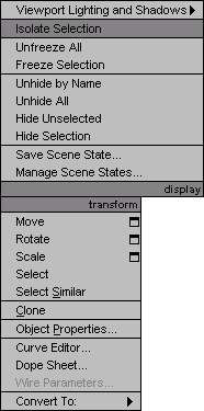

Isolate the utility containers:
3ds Max selects the various containers.
This command is in the upper-right, Display quadrant.
3ds Max displays the utility containers in the center of the viewport, and hides the other scene geometry.
The isolated set of containers

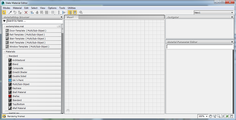

Also, to see changes in the viewport, it will help to minimize the Slate Material Editor while you work, and then restore it when you need to work on materials some more.

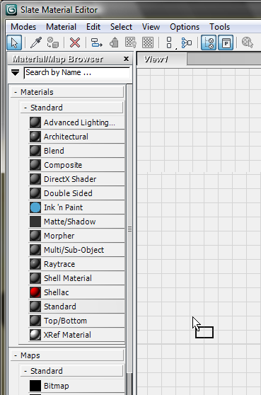

The Material Editor is a workbench for creating, adjusting, managing, and applying materials to objects. The main portions of its interface are:
Slate Material Editor. The Compact Material Editor has a smaller window, with conspicuous sample slots near the top of its interface.

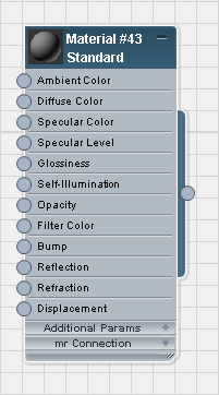

Standard
Standard, then drag the Standard entry from the Browser and drop it in the active View (the large panel labeled View1 in the center of the Editor).
A node for the Standard material appears in the active View.

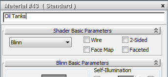

Notice that as you enter the name in the Name field, the name in the title bar of the node also updates.
It is good to get in the habit of naming a material as soon as you create it. In a complex scene, intelligible material names are useful.

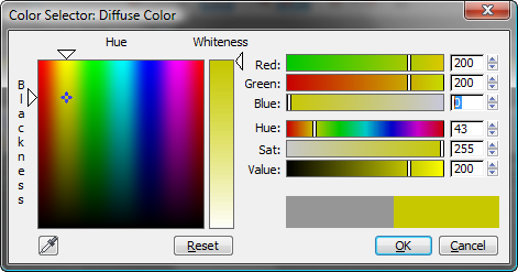

3ds Max opens a Color Selector dialog.
Use the Red/Green/Blue controls on the Color Selector to choose a yellow color. Set Red = 200, Green = 200, and Blue = 0.
The diffuse color of a material is the color that appears under diffuse, or scattered, light. It is what we usually think of as “the” color of a material, and what you will set first, when you create a basic material such as this one.
In the viewport, the oil canisters turn yellow.

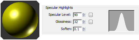

Make the oil tanks shiny:
Make sure that the three oil tanks are still selected, and that the Oil Tanks material is still active.
Bright highlights appear on both the sphere in the preview, and the oil tanks in the viewport.
Left: Preview with the oil tank material
Right: Specular highlight controls with Glossiness = 32
As you can see the preview and in the graph to the right of the Specular Highlight and Glossiness controls, the highlight is now narrower. Specular Level controls how bright highlights are, while Glossiness controls highlight width. In general, shinier materials have smaller highlights.
You have used basic material controls, Diffuse color, Specular Level, and Glossiness, to create a simple material that has the appearance of a moderately shiny paint. This completes the material for the oil tanks.

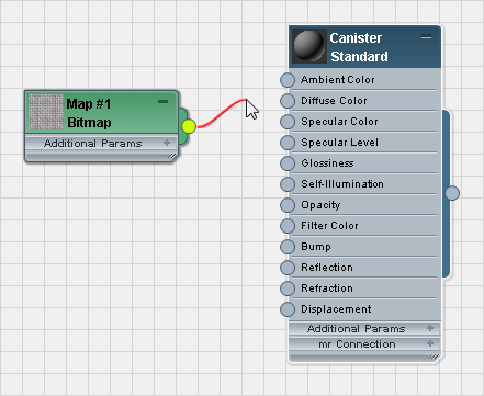

Bitmap, and drag this map type into the active View. 3ds Max opens a file dialog.

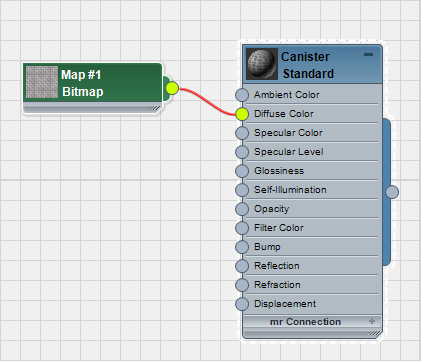

3ds Max adds this Bitmap node to the active view.
Drop the wire on the input socket for the Canister node’s Diffuse Color component.
The Bitmap is now wired to the material.

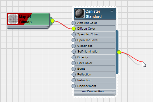

A red diagonal shape appears in the Bitmap title bar, to indicate that Show Material is active.
Dragging from the output socket of the Canister material
3ds Max applies the Canister material to the ammunition canister.
Dragging and dropping from the output socket of a material node is an alternative to using

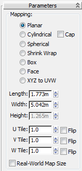

To fix this, you use a modifier called UVW Map.
Mapping group, choose Box. The radio buttons at the top of the Mapping group (Planar, Cylindrical, Spherical, and so on) tell the UVW Map modifier how to project the map onto the object. Box mapping projects the map from all six sides, so the texture display is more uniform.
Now the mapping is uniform and looks good from any angle.
The texture corrected using UVW Map

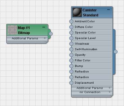

Clean up the Slate Material Editor interface:
active View, click a node to select it, then press Ctrl+A to select all nodes in the View. Deleting nodes from the active View simply cleans up the View for further work. It does not remove the materials from the scene: You can still see the materials you created in the Material/Map Browser
Scene Materials group.
If you need to edit a material again, you can drag it from this group and into the View as an instance.
