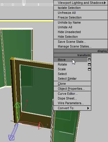

  3. Right-click the Perspective viewport and choose Move from the menu.
    This right-click menu is called the quad menu. You can use it to access tools from the toolbar and command panel for quicker workflow. You can even customize it to keep your favorite tools right under your fingertips.
  4. On the status bar, right-click the spinner arrows for the X and Y coordinates (and Z too, if necessary) to set each of these fields to 0' 0.0".
    This moves the pivot point for the door to the origin, (0,0,0), which is also the pivot point for the cylinder.

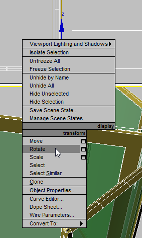

  1. Right-click the Perspective viewport again and choose Rotate from the quad menu.
