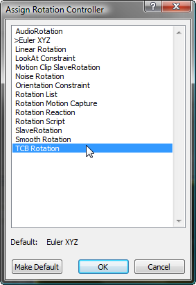

- In the Assign Controller window, click to highlight the Rotation: Euler XYZ item.
- Click
(Assign Controller).
- On the Assign Controller dialog, click TCB Rotation, then click OK.
The rotation controller listed in the Assign Controller rollout changes to TCB Rotation.

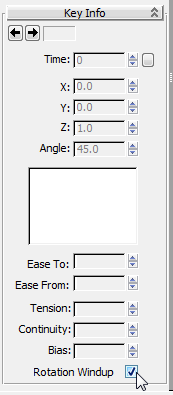

- Scroll down to the bottom of the Key Info rollout and turn on Rotation Windup. This will allow you to set rotation keys greater than 180 degrees.
Important: You must turn on Rotation Windup, or the animation won't work correctly.

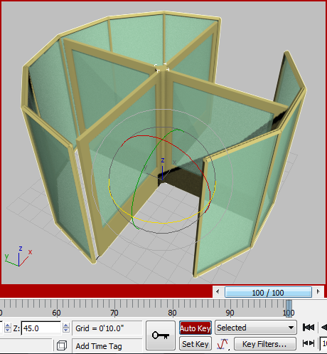

Animate the hub:
- Turn on
- Drag the time slider to frame 100.
- Click to activate
(Select And Rotate).
- Rotate the hub 360 degrees about the Z axis. Watch the coordinate display to get the correct rotation.
Tip: To make setting rotations easier, turn on Angle Snap by pressing the A key.
The Time Slider now displays keyframes as small rectangles at the beginning and at the end of the time segment.
Rotation key at frame 100

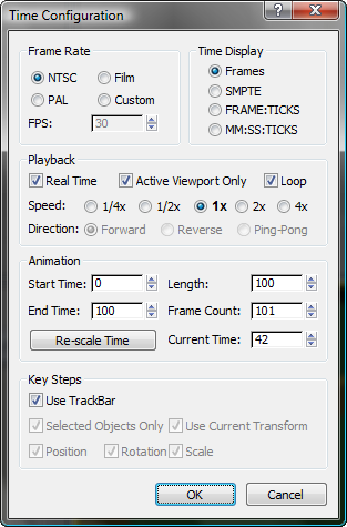

Slow down the animation:
To slow down the rotation of the revolving door, do the following:
- Click
(Time Configuration). 3ds Max opens the Time Configuration dialog.

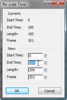

- In the Animation group, click Re-scale Time.
- On the Re-scale Time dialog, change End Time to 200, then click OK.
- Click OK to close the Time Configuration dialog.
The Time Slider now displays 200 frames, with a key at frame 0 and frame 200.
