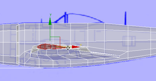

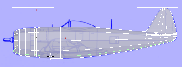

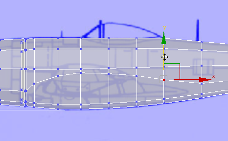

Create the “foundation” for the left-hand wing:
- On the ribbon
Edit panel, click
(Swift Loop).
- In the Front viewport, use Swift Loop to create a longitudinal loop of edges near the bottom of the fuselage.
- Right-click to exit the Swift Loop tool.
- Go to the
(Vertex) sub-object level.
- On the ribbon
Edit panel, activate
(Constrain To Edge).

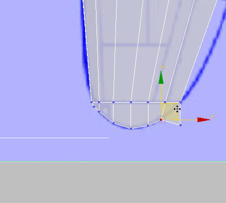

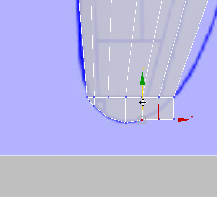

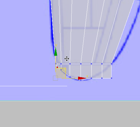

- In the Front viewport, along the edge above the new edge loop,
move vertices vertically to make a contour that will surround the wing faces.
- On the ribbon
(Constrain To None).
- Click
(Vertex) again to exit the Vertex sub-object level.

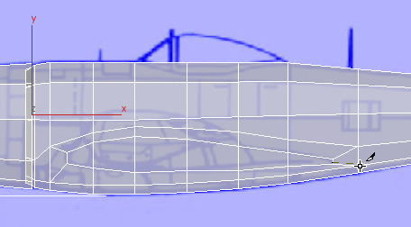

- On the ribbon
Edit panel, click
(Cut).
- In the Front viewport, use the Cut tool to create edges around the outline of the wing. You can use some of the blueprint image to help locate these cuts, but for the forward part of the wing, use the contour above it and the following illustration.
- Right-click to exit the Cut tool.
- Turn on
(Cut) once again, and as you did for the stabilizer, add edges from the free-standing vertices at the leading and trailing edges of the wing to the nearby corner vertices, to make sure all polygons are quadrangular.

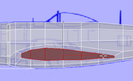

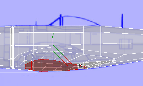

Begin to extrude the wing:
- Go to the
(Polygon) sub-object level.

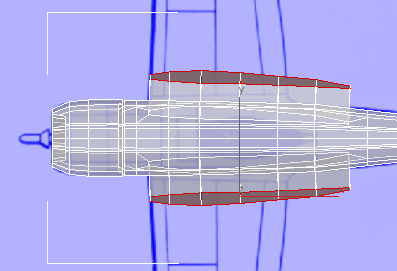

Click and Ctrl+click to select the faces that make up the base of the wing.
- On the ribbon
Polygons panel, click
(Extrude). Then drag to extrude the faces a short distance. Tip: As you did for the stabilizer, drag in the Front viewport but watch your work in other viewports, especially the Top view.
Top view

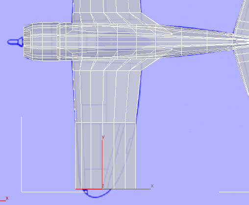

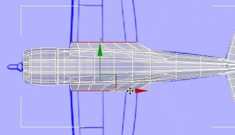

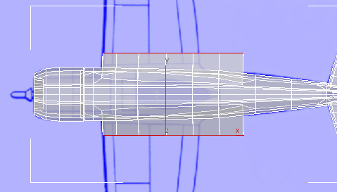

- On the ribbon
Align panel, click
(Align X).

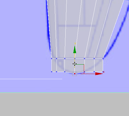

Scale the faces along their X axis and
move them in both X and Y so the wing extrusion matches the blueprint image in the Top viewport. Tip: This step won’t work if constraints are active: Make sure that
(Constrain To None) is active.

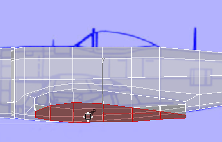

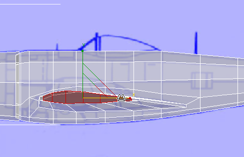

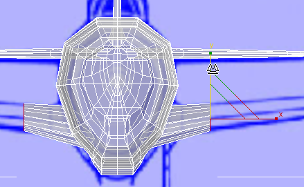

- In the Left view,
scale and
move the faces along their Y axis so the wing matches the blueprint image.
Tip: At this point, if the upper surface of the wing seems too low, you can go to the
(Vertex) sub-object level, activate
(Constrain To Edge), and
move the vertices along the base of the wing’s upper edge upward along the fuselage (it’s easiest to select these vertices in the Perspective viewport). Be sure to activate
(Constrain To None) when you’re done.
- At the
(Polygon) sub-object level,
extrude the wing as far as the seam at its middle.

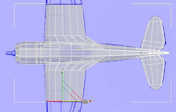

Finish extruding and shaping the wings:
Extrude the wing as far as the last seam.
Top view
- Once again,
scale and
move the faces so the wing matches the blueprint image in the Top viewport.
Top view
- Do the same in the Left viewport.

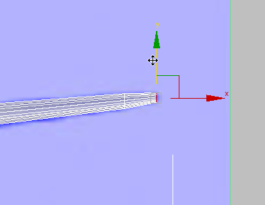

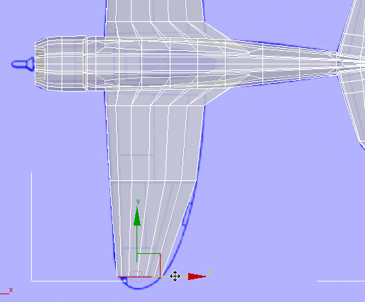

Extrude the wing again, this time to the very tip.
Top view
Note: The long edge segments don’t do justice to the curvature of the wings, especially at their trailing edges. In the next lesson, you will refine these the way you refined the curvature of the fuselage.

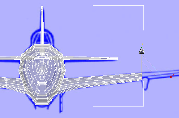

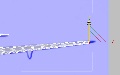

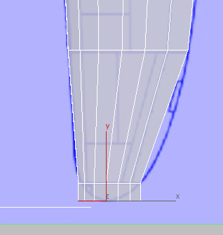

- In the Left viewport,
scale and
move the faces to match the wing to the blueprint image.

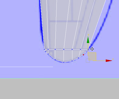

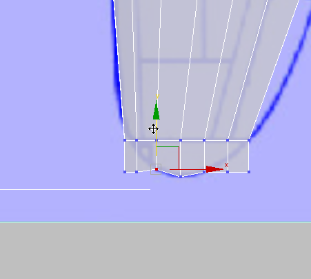

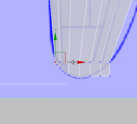

- Go to the
- In the Top viewport, use region selection to select pairs of vertices (top and bottom), and
move them so the curve of the wing tip matches the blueprint image.
