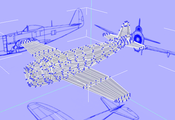

Check your work:
  1. In the Perspective viewport, orbit around the model to make sure the wings are even.
    If any vertices seem out of place, especially along the vertical axis, move them to improve the wing’s appearance.

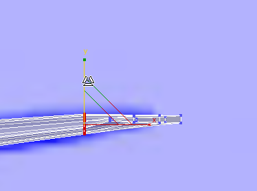

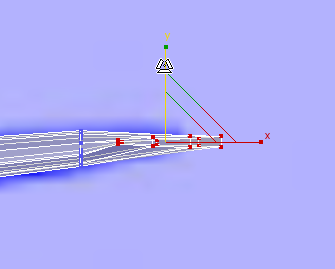

  4. In the Left viewport, select the wingtip vertices, and scale them down a bit vertically.
  5. Do the same for the vertices at the wingtip seam.
    These adjustments are more intuitive than quantitative: Aim for a result that is visually pleasing to you.

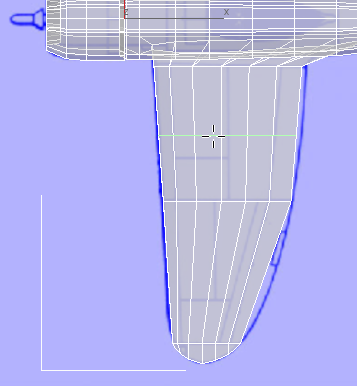

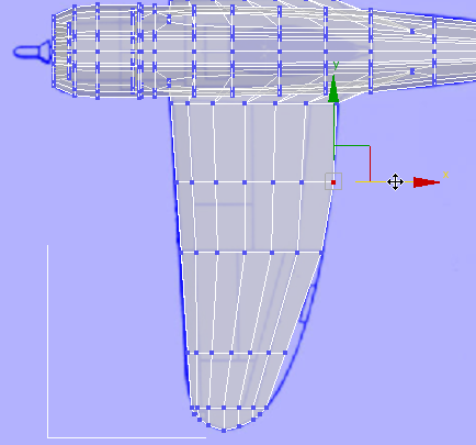

Refine the curvature of the wings:

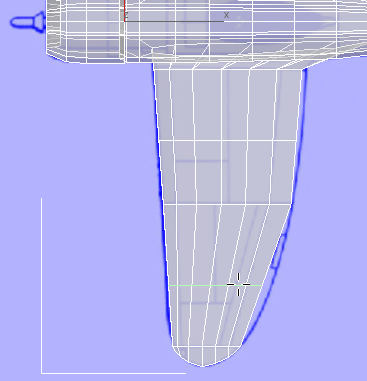

  1. Zoom and pan the Top viewport so you can see all of the left-hand wing.
  2. On the ribbon Edit rollout, turn on (Swift Loop). Then in the Top viewport, use Swift Loop to add two new edge loops that subdivide the long faces on the wing.
  3. Right-click to turn off the Swift Loop tool.

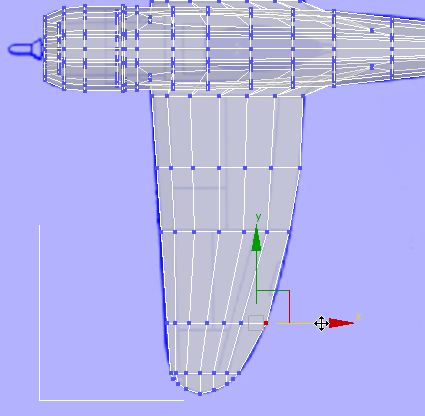

  4. Go to the (Vertex) sub-object level again, region-select vertices at the trailing edge of the wing, then move them to better match the curvature of the wing, as shown in the blueprint image.
  5. Click (Vertex) again to exit the Vertex sub-object level.
