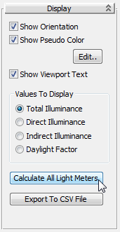

Display rollout and click Calculate All Light Meters.
A progress bar appears in the status-bar area of the 3ds Max window. After a few moments, the viewports update to display the readings calculated by each sample point, based on the lighting data you defined for the CIE sky model.

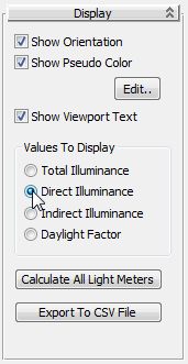

Values To Display group, choose Direct Illuminance.
The sample points all return a value of 0 because, being an overcast day, there is no direct sunlight to record.
Light meter readings detect no direct luminance
The values are identical to those of step 2, because Total Illuminance measured no direct sunlight.

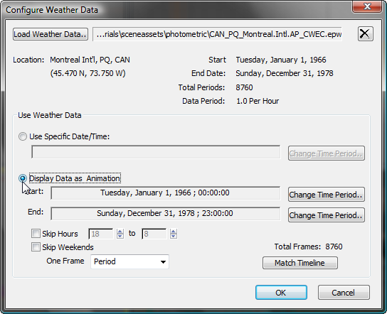

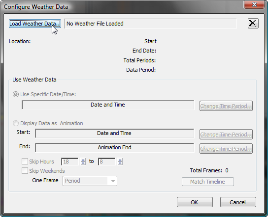

The U.S. Department of Energy Web site opens to the EnergyPlus Energy Simulation Software Weather Data Web page.
The weather data might take a moment or two to display.
The data file is a ZIP file that includes an EPW file. The EPW file has the data you need to perform the lighting analysis.
Daylight Parameters rollout

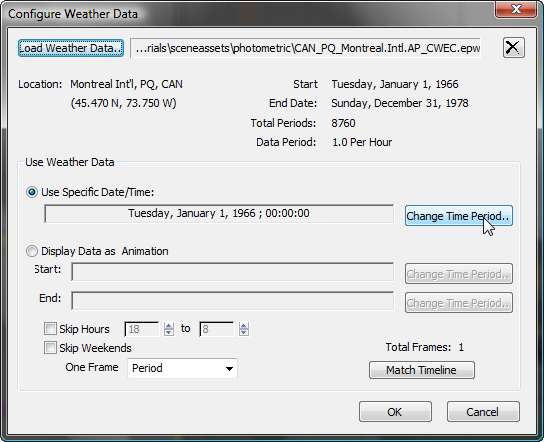

Position group, choose Weather Data File, then click Setup.
Use Weather Data group, click Change Time Period.

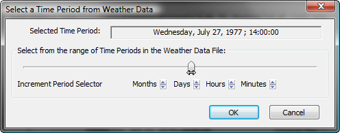

By default, the weather data is set to January 1st, 1966, at noon, but you will choose a summer date.
Use the Increment Period Selector controls to narrow down the selection if you need to. Click OK.
Now the “mr Sky: Perez Parameters” rollout Diffuse Horizontal and Direct Normal Illuminance fields display the diffuse lighting and direct lighting applied to the Perez model by the weather data file.

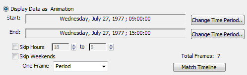

Next, you will extract a range of weather data to see how the illuminance values change over a six-hour period of time, ranging from mid-morning to mid-afternoon.
Choose a range of weather data:
Position group, click Setup.
The Use Weather Data group indicates a total of seven frames created as a result of the selection range.
The timeline updates to show seven frames.

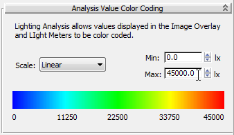

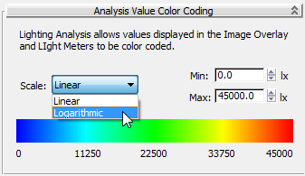

Lighting Analysis Assistant, and go to the General panel. The Analysis Value Color Coding rollout displays a color ramp. The ramp intensity range is currently set between 0.0 and 10000.0 units. The units are in lux (lx), the international unit of measure. If you prefer, you can switch to the United States unit of measure, foot-candles (fc) on the Units Setup dialog.
Given that the scene illumination is over 42,000 lux in places, the color range is currently too narrow. You need to widen the color ramp range.
In the viewport, the color range now shows light intensity much more effectively.
Light meter readings showing improved color coded feedback
The orange areas of the tennis court interior show direct sunlight for this time of day, while the blue areas show indirect sunlight.
Scale drop-down list, choose Logarithmic.
The color-coded areas update to provide a different visualization of the light intensity, but the intensity values themselves remain unchanged.
