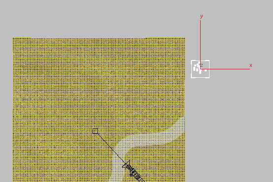

  1. Go to the Create panel and activate (Geometry). Open the Objects drop-down list, and choose “mental ray.” On the Object Type rollout, click to activate “mr Proxy.”
  2. In the Top viewport, click and drag anywhere to the right of the plane object.
    The proxy object you create can be of any size.
  3. Go to the Modify panel and rename the object Elm-Winter.

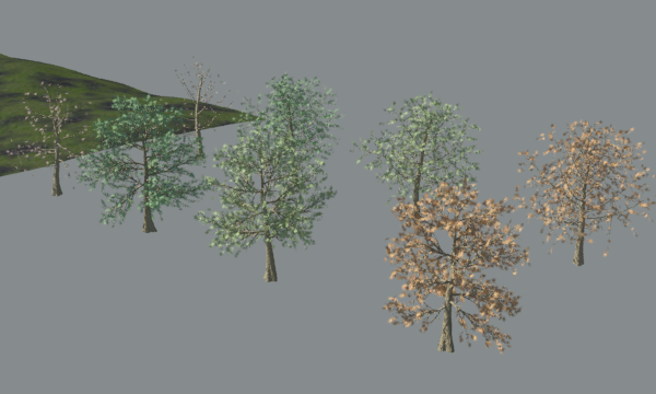

  1. Activate the Camera01 viewport. Press P to make it a Perspective view. Zoom, pan, and orbit so you have a good view of all eight tree proxies, then render the Perspective viewport.
    Tree proxies with the same material
    The tree proxies have different shapes and leaf densities, but their leaves and trunks are all the same color. In the next procedure, you will associate each proxy with a material you saved earlier in the material library.

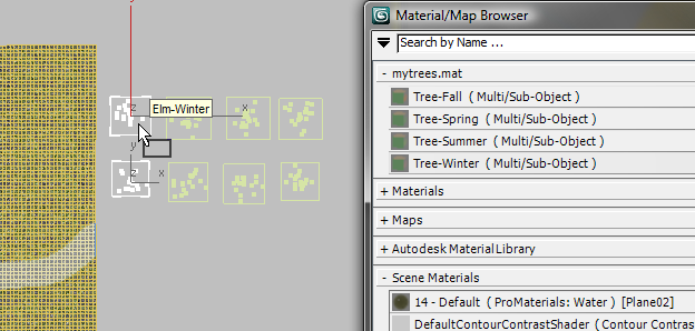

Assign materials to the tree proxies:
  1. From the main menu, choose Rendering Material/Map Browser.
  2. In the Top viewport, Click and Ctrl+click to select Elm-Winter and Oak-Winter, then drag the Tree-Winter material from the Material/Map Browser mytrees.mat group, and drop this material on your selection.
    3ds Max opens an Assign material dialog. On the dialog, make sure Assign To Selection is chosen, then click OK.
  3. Repeat the previous step for each of the spring, summer, and fall pairs of tree proxies, using the appropriate library material.

  5. Render the Perspective viewport once again.
    Tree proxies after receiving materials from the material library
    Now you have eight different types of trees that are ready to be multiplied and distributed across your scene.
