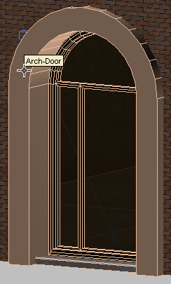

Maximize the Orthographic viewport and
select the Arch-Door object.
Arch door object with no material applied

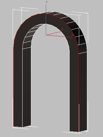

(Show Shaded Material In Viewport). (If you use a legacy viewport driver, this button's tooltip reads, "Show Standard Map In Viewport.") The arch turns a dark gray. It shows no further detail because no mapping coordinates have yet been specified for the Arch-Door object.

- Right-click the arch object in the viewport and from the quad menu, choose Hide Unselected to isolate the object.
Arch object with brick material mapped to its surface

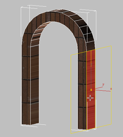

- In the viewport,
select a face on the arch object. 3ds Max displays a yellow gizmo, representing a planar projection of brick material onto the selected face.
Planar projection of brick material onto an arch face
Select another face on the arch object. Notice how the yellow gizmo resets onto the newly selected face.

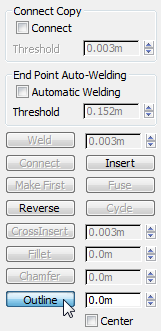

- On the Geometry rollout, scroll down so you can see the Outline button, and then click it.
- In the viewport, click the original spline and drag inward so the outline spline is positioned roughly at the midpoint between the outer and inner edges of the front face of the arch.

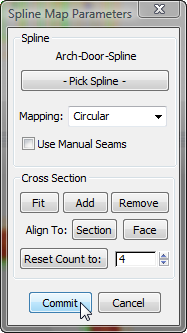

- On the Modify panel, scroll down to the Wrap rollout and click
(Spline Mapping).

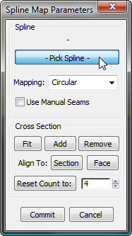

- On the Spline Map Parameters dialog, click Pick Spline.
For now, leave the Spline Map Parameters dialog open.
- Press H and on the Pick Object dialog, choose Arch-Door-Spline from the list, then click Pick.

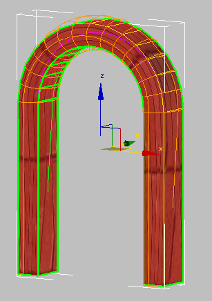

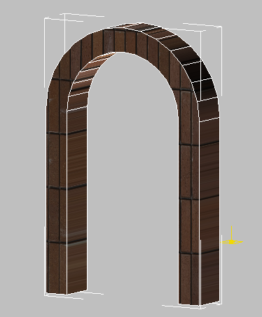

The arch object is enveloped by a cage gizmo, which shows the outline and cross sections of the mapping.
Arch object enveloped by the cage gizmo
Now you need to correct the base of the cage gizmo, which is too narrow for the arch geometry.
Adjust the mapping gizmo:
Orbit the viewport until you can see the two unselected faces at the base of the arch.
Bottom of arch, showing that the cage gizmo is too narrow
- On the main toolbar, activate
(Select And Uniform Scale), For each base of the arch, click to select the base of the gizmo, then drag the Scale gizmo along its Y axis until the cage is at least as wide as each face at the base of the arch.
Cage gizmo after resizing each base
You do not need to be precise at this point: In the next lesson, you will specify the cage more precisely by using the Unwrap UVW controls.
- On the Spline Map Parameters dialog, click Commit to accept the changes made to the spline mapping so far.
