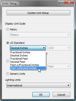

  2. On the menu bar, choose Customize Units Setup.
    The Units Setup dialog appears.
  3. In the Display Unit Scale group, choose US Standard, if necessary.
    Set the scale to Feet w/Decimal inches, if necessary.
    Note: Leave the System Unit Setup as it is. This should be changed only to reset the system unit to the default setting (inches) after loading a file that uses a different system unit, or if you are working on files that are so huge or so tiny that values don't appear correctly in the numeric entry fields.
  4. Click OK to accept the change.
    Now, when you make something, its measurements are displayed in the command panels in familiar real-world terms.

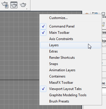

  1. By default, the Layers toolbar is hidden when you start 3ds Max. If it is not currently open, right-click a blank space on the main toolbar and choose Layers from the pop-up menu.

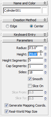

    Immediately after creating an object, you can modify its parameters such as size and shape by changing these values on the Parameters rollout on the Create panel.
    Tip: If while changing these values you accidentally exit create mode (say, by right-clicking the viewport), the object remains selected but its parameters are no longer available on the Create panel. At this (or any) point you can go to the Modify panel and adjust the parameters there, or you can simply undo the new object (Ctrl+Z) and start over.

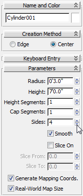

  1. On the Parameters rollout change the Radius value to 0' 3.0", then change the Height to 7' 0.0".
  2. In the Navigation controls, click (Zoom Extents).
    The viewport zooms so you can see the entire cylinder.
  3. On the Parameters rollout, change Height Segments to 1, then change Sides to 4.
    Tip: The lowest possible Height Segments value is 1. You can minimize the value of a numeric field by right-clicking the spinner arrows to the right of the field where you can type.
    The Cylinder changes into a tall box with four sides; this will make it easier to create the door. Later you'll change the pole back to a cylinder.
