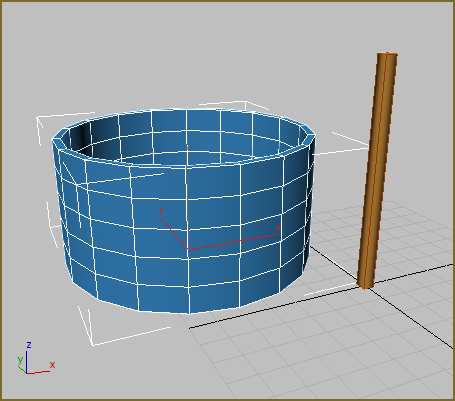

Create the tube:
  1. On the navigation controls, click (Zoom Extents) to zoom back so you can see the area around the cylinder.
  2. On the Create panel Object Type rollout, click to activate Tube.
    The Tube button highlights, indicating it is active and ready for use.
  3. Drag out a tube anywhere in the viewport.
    The size doesn't matter; you'll be changing it in a moment.
    Make a tube.
  4. In the Parameters rollout on the Create panel, change Radius 1 to 6' 0.0".
  5. Change Radius 2 to 5' 11.0"
  6. Change Height to 7' 0.0".
    Change the radius and height of the tube.

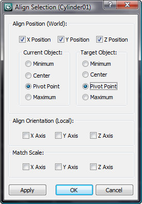

Align the tube:
    Next, you'll center the tube over the cylinder.
  1. On the toolbar, click Align.
    The tube is already selected, so you'll align it to the cylinder.
  2. Click the cylinder in the viewport.
  3. In the Align Selection (Cylinder01) dialog Align Position (World) group, turn on X Position, Y Position, and Z Position. Choose Pivot Point for both Current Object and Target Object. Click OK.
    The tube is centered over the cylinder.

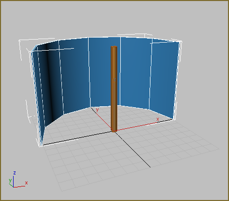

Slice the tube:
  1. Go to the Modify panel.
  2. On the Parameters rollout, turn on Slice On.
  3. Adjust the Slice From and Slice To values so you have a half of a tube visible in the viewport, resembling the illustration. Set them to 90.0 and –90.0 degrees.
    Slice the tube
  4. Change Sides to 6. The enclosure will be created out of flat panels, rather than curved glass.
  5. Change Height Segments to 1.
    Lower the number of faces.
