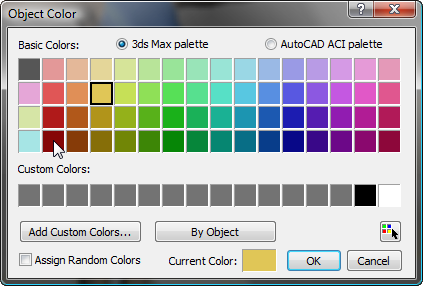

Change the color of the skirt:

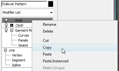

Use the Shell modifier to give the clothes some thickness:
At present, the pullover and the skirt are extremely thin: In fact, technically they have no thickness. This can become a problem when you animate the cloth, especially the pullover: Patches of skin might appear through the fabric. To avoid this “wardrobe malfunction,” use the Shell modifier to give the garments some thickness.
Two millimeters is a realistic thickness for a piece of cloth.
Now the pullover and skirt both have an equal thickness.
