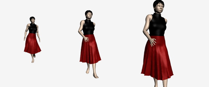

In this tutorial, you will remain in the human realm, and create the clothing for a fashion model. Aside from her shoes, which are already supplied, the model wears two outer garments:
With Garment Maker, you specify the construction of clothing, based on pattern shapes. The Cloth modifier then fits those clothes to the character who wears them; later, Cloth also generates realistic animation for the clothing.
