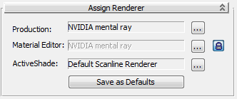

Choose the mental ray renderer:
- On the main toolbar, click
(Render Setup).
- On the Render Setup dialog
Common tab
Assign Renderer rollout, make sure the Production field is set to NVIDIA mental ray.
The Multi/Sub-Map is a mental ray feature. It is available only when you choose mental ray or the Quicksilver Hardware renderer as your renderer.
Close the Render Setup dialog.

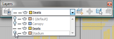

Group objects by ID number:

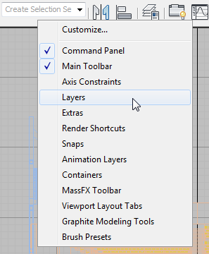

- Right-click an empty area of the main toolbar and from the pop-up menu, choose Layers.
3ds Max opens the Layers toolbar.
- On the Layers toolbar, open the layers list and click to hide all layers except Seats.
Now only the seats objects are visible, making their selection much easier.
- Close the Layers toolbar and

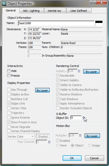

Select any seat object, right-click and from the quad menu, choose Object Properties.
Notice that in the Object Properties dialog
General tab
G-Buffer group, the Object ID displays as 0. All objects when they are first created are assigned an ID of 0. Later on, you will change this number in order to assign certain groups of seat objects their own material variations.

- Right-click, choose Object Properties from the quad menu, and in the Object Properties dialog
General tab
G-Buffer group, change the Object ID to 1. Click OK.

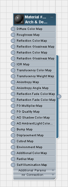

- From the Material/Map Browser panel on the left, drag an Arch & Design material into the active View (View1), the empty area in the center of the Slate Material Editor window.
In the Browser, the Arch & Design material is in the Materials
mental ray group.
A node for the Arch & Design material appears in the active View.
- Double-click the Arch & Design material node to display its parameters in the Parameter Editor panel on the right.

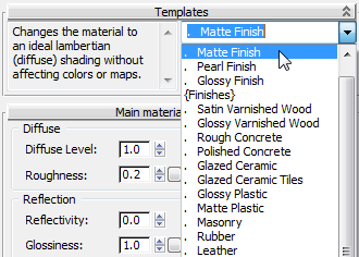

- On the Templates rollout, open the drop-down list and choose Matte Finish.

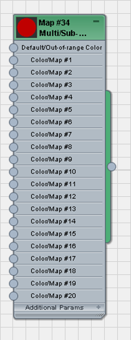

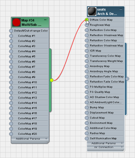

- On the Slate Material Editor, drag a Multi/Sub-Map from the Material/Map Browser panel to the active View.
You can find the Multi/Sub-Map entry in the Maps
mental ray group.
A node for the Multi/Sub map appears in the active View.
- Drag from the output socket of the Multi/Sub-Map node (the round control at the right of the node). 3ds Max creates a wire. Drop the end of the wire on the input socket for the Diffuse Color Map component of the seats material node.
- Double-click the Multi/Sub map node to display its parameters.

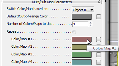

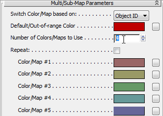

- On the Multi/Sub-Map Parameters rollout, set the Number Of Colors/Maps To Use to 4.
By default, Switch Color/Map Based On is set to Object ID, meaning that the sub-maps will be distributed among the objects by their ID number. You have already set up the object IDs.
The Default/Out-Of-Range Color is set to red. This means the material of any object in the scene with an ID other than 1 to 4 will display in red. Red is one of the seat colors we are using, so click this color swatch and use the Color Selector to change this color to a neutral gray.
Note: If you were to turn on the Repeat option, all objects with IDs higher than 4 would display the color sequence assigned to objects with IDs 1 to 4.
- Click the color swatch labeled Color/Map #1.
- On the Color Selector, change the color to a bright red: Red = 0.8, Green = 0.0, Blue = 0.0, then click OK.
- Click the color swatch labeled Color #2 and change the color to a blue: Red = 0.275, Green = 0.534, Blue = 0.814, then click OK.
- Click the color swatch labeled Color #3 and change the color to a yellow: Red = 0.867, Green = 0.808, Blue = 0.231, then click OK.
- Click the color swatch labeled Color #4 and change the color to a green: Red = 0.158, Green = 0.583, Blue = 0.141, then click OK.

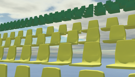

- Activate the Camera-Seats viewport.
- In the rendered frame window’s Viewport list, make sure Camera-Seats is chosen, then click Render to render the scene again.
