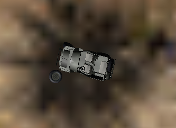

The scene is of a desert landscape. There are scorched areas on the ground, and the wreckage of a jeep ® .

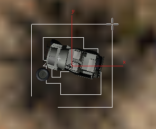

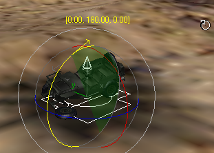

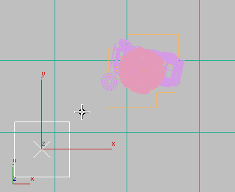

The jeep is in the road, toward the right-hand side of the landscape.
Particles will be emitted from the area of the circle, which is a bit smaller than the size of the jeep itself.

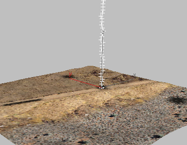

Now the particles move upward instead of downward, and you can see them in all four viewports.
At present, the particles appear in a single burst, between frame 0 and frame 30, then no more particles appear. You will correct this, and also set up some other particle behavior, in the procedure that follows.

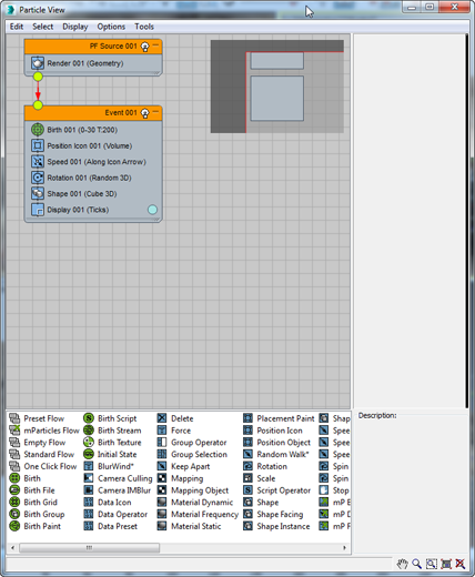

Adjust the Particle Flow settings:
3ds Max opens a Particle View window.

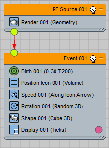

Particle View is the main interface to Particle Flow systems. This is where you add and adjust the particle behavior. In the window, the main areas are the event display at upper left, which shows events you’ve already created, and the “depot” at lower left, which contains operators that you can add to the event display.

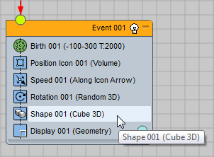

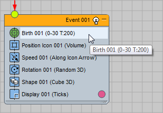

At present, the event display shows the PF Source 01 operator you added to the scene, and Event 01, which so far contains default settings.
On the right side of Particle View, 3ds Max displays a parameters rollout for the Birth operator. As the fields show, the Birth operator generates 200 particles in all. It starts emitting particles at frame 0, and stops emitting them at frame 30.

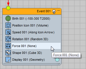

Starting emission at an imaginary frame –100 means tells 3ds Max to generate particles before the animation begins, so there will already be some smoke in the scene at frame 0. Stopping particle emission at frame 300, the last frame of the animation, means that smoke will continue to appear throughout the animation.

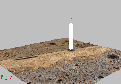

Particles are present at frame 0, and they continue throughout the animation, but so far, they aren’t exactly billowing.
Now the particles are more numerous and beginning to look a little more like smoke, but they are still moving too quickly.
In the parameters panel on the right side of Particle View, 3ds Max replaces the Birth rollout with a Speed operator rollout.
Now the smoke rises more slowly, in a dense column. This is a better effect, but its path is unnaturally straight and vertical.
Before you add effects to make the smoke behave naturally, you will adjust its viewport display to see the effect a little better.
Now the parameters panel shows a Display operator rollout.
Clicking either the swatch or the dot displays a Color Selector that lets you change the display color.
Now the particles appear as a mass of tiny cubes, as you can see in the Perspective viewport.
This is not meant to be the final form of the particles: It is just a temporary setting to help you visualize the effects you are about to add.

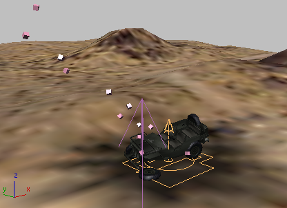

Add a space warp for the updraft:

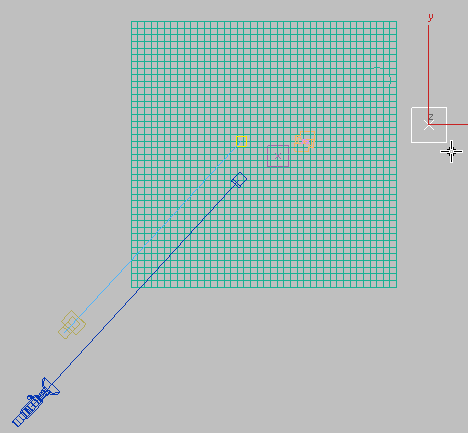

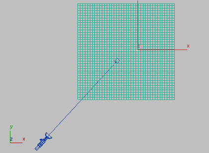

To give the column of smoke more realistic motion, you will add a couple of Wind space warps to the scene.
The Wind space warp icon is a square with an arrow coming out of it. In shaded viewports, the square is hidden by terrain, but in the Perspective viewport, it is easier to see the arrow.
This space warp will model the updraft caused by the heat of the fire itself.
Add a space warp for wind:
This space warp will model an actual wind coming from the east.

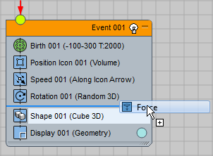

Force operator in the depot
Dropping the Force operator on the event
3ds Max displays the Force operator parameters in a rollout on the parameters panel to the right.

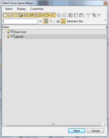

3ds Max opens a Select Force Space Warps dialog.
The particles move upward and toward the west, as we want them to, but now they are so widely dispersed that the smoke is hardly visible. This is because the default Wind settings are too strong. You will correct that in the next procedure.
