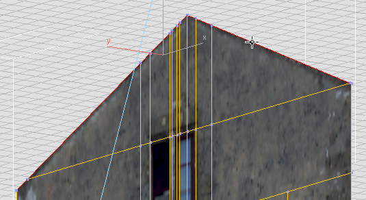

Select the edges along the top of the façade.
Tip: It can be hard to select the very small edges near the peak: Make sure the Window/Crossing toggle is set to
(Window), and drag a box around them.
Ctrl+click to add the longer edges to the selection.

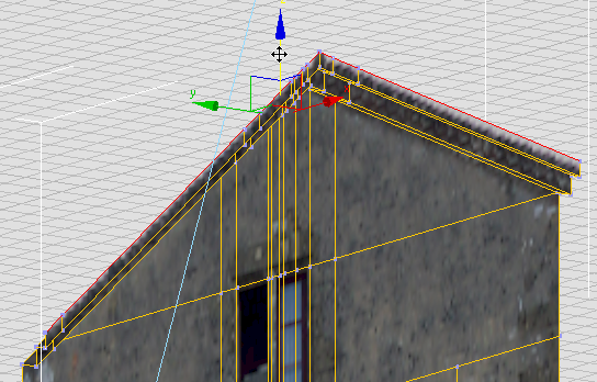

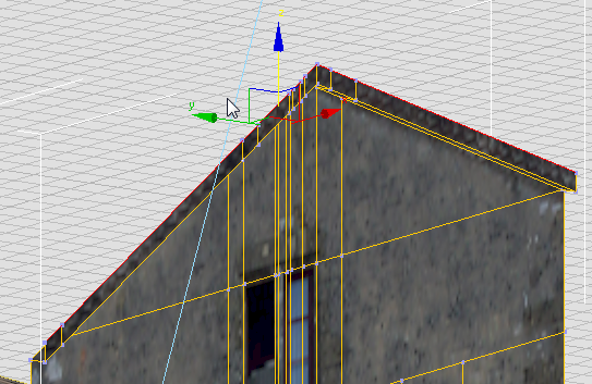

- Shift+move the edges forward a bit along the Y-axis.
- Shift+move the edges up a bit along the Z-axis.
- Shift+move the edges forward along the Y-axis, and then Shift+move them up along the Z-axis once again, to complete the cornice.
