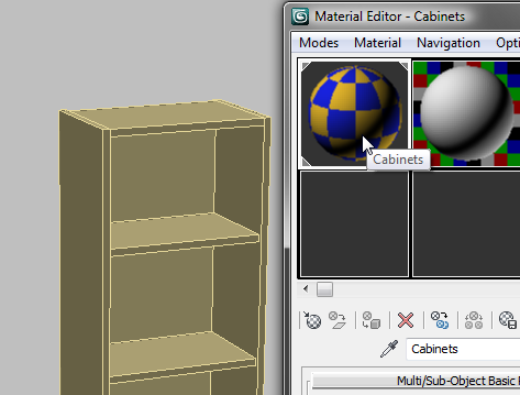

Next, you will assign material IDs to the polygons so they can receive different sub-materials.
Assign Material IDs:
- On the main toolbar, click
(Material Editor) to open the Compact Material Editor.
- Click the top-left sample slot to make it active. The material in this slot is named Cabinets.
- Drag from the Cabinets sample slot and release the mouse over the upper cabinet to apply this material.
Dragging and dropping is an alternative way of applying materials.
Close the Compact Material Editor.
