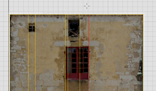

Add edges for the windows:
Zoom the viewport so you have a good view of the three windows in the upper portion of the wall.
- On the Modeling tab
Edit panel, click to turn on
(Swift Loop). The SwiftLoop tool adds edges to the Editable Poly surface by drawing a “loop” from one edge to another.
- Drag over the façade near the top edge. 3ds Max constructs a vertical edge, which you can move.
- Click to set a vertical loop at the left edge of the small window in the upper left of the façade.
- Add additional vertical loops for the other window edges.
- Add horizontal loops to define the tops and bottoms of the windows.

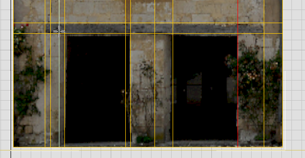

Add edges for the lintel beam and the doorways:
Pan down to get a good view of the doorway area.
- Add loops to outline the lintel.
Note: The lintel beam is not perfectly rectangular. You will adjust its outline in a later procedure.
- Add a vertical loop for the edge of the right-hand doorway. (The other vertical door edges match edges you already created for the windows.)
- Also add vertical loops to the left of each dark area, where the wall angles into the doorway.
Loop for the angle of the left doorway’s left-hand doorjamb
Loop for the angle of the right doorway’s left-hand doorjamb
- Finally, add a horizontal loop to define the elevation of the doorstep.
- Right-click to turn off the Swift Loop tool.

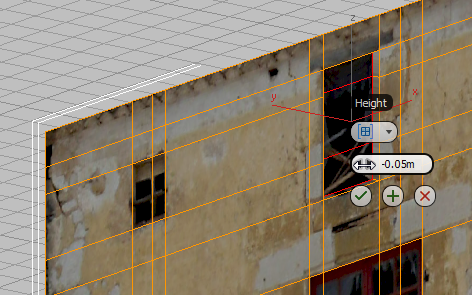

- On the ribbon, click
(Polygon) to go to the Polygon sub-object level.
Click and Ctrl+click to select the three faces of the top center window.
- On the ribbon
Polygons panel, click the drop-down arrow next to the
Extrude button, and choose Extrude Settings.
3ds Max displays an interactive manipulator called a “caddy.”
- Drag the arrows by the Height control, and extrude the window back by about –0.05m.
Tip: You can also simply type –0.05 in the Height field, and then press Enter.
- Click
(OK: the check-mark icon at the bottom of the caddy) to complete the extrusion.

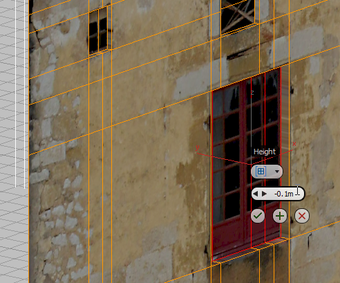

Add depth to the other two windows:
Click and Ctrl+click to select the two polygons of the small window at the upper left.
- On the ribbon, Shift+click
(Extrude). Shift+click is a shortcut way to display the caddy for a modeling tool.
- The caddy defaults to the previous value you used for Extrude Polygons, so just click
(OK) so the small window matches its larger neighbor.
Click and Ctrl+click to select the four polygons of the main window in the center of the wall.
(Extrude).
- This window should have more depth than the smaller windows, so in the Height field, enter –0.1m, then press Enter.
- On the caddy, click
(OK).
Now the windows for Facade1 are done.
