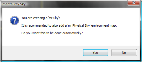

3ds Max opens the “mental ray Sky” dialog, asking if you want to add an “mr Physical Sky” environment map for the background of your scene.

The sky map is cosmetic, and while it will create a nicely shaded background to the scene exterior, it will not affect the interior lighting levels in any way.

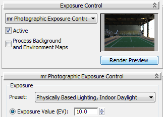

The preview thumbnail takes a moment or two to render. The resulting image is quite dark because the default Exposure Value of 15 is not suitable for an indoor scene.
Render preview with Exposure Value set to 15.

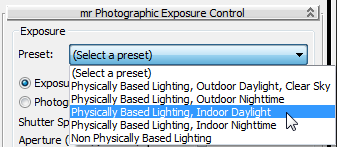

Exposure group
Preset drop-down list, choose Physically Based Lighting, Indoor Daylight.
The Exposure Value changes from 15 to 10 and the render preview thumbnail appears somewhat lighter.
The preview updates to show the effect of the new setting.

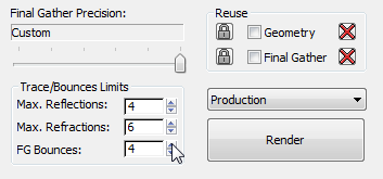

Specifying even lower exposure values causes the scene to appear brighter. Now you will enhance the illumination of the scene by using Final Gather to increase light bounces.
This increases the number of times a ray of light bounces on object surfaces in a scene. Values of 4 through 7 are the most effective. Values under 4 produce less noticeable results, while values over 7 require a great deal of render time, with limited added benefit.
Exposure Control rollout, click Render Preview again to see how the added bounces have brightened up the interior of the model.

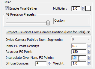

Use custom Final Gather settings to improve the quality of the rendering:
Global Illumination tab
Final Gathering (FG) rollout
Basic group, set Initial FG Point Density to 0.2, Rays Per FG Point to 150, and Interpolate Over Num FG Points to 50.
These values will eliminate most of the noise artifacts in the scene while ensuring a reasonably fast calculation time.
