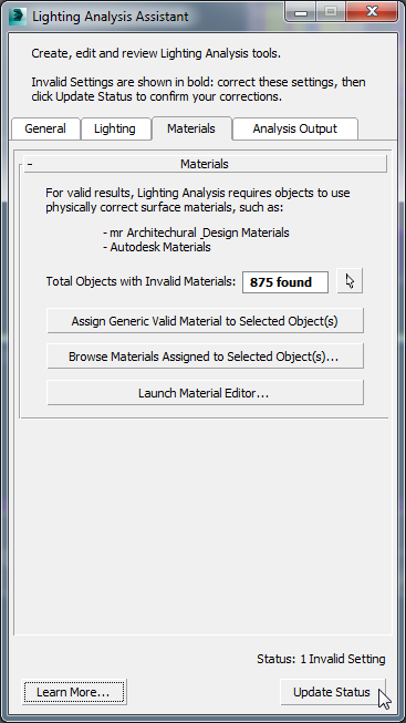

Open the Lighting Analysis Assistant and check the status of the scene:
Lighting Analysis Assistant. 3ds Max opens the Lighting Analysis Assistant dialog. This is where you activate and edit the tools used to analyze lighting in a scene.
The status line at the bottom of the dialog indicates the number of invalid settings, if any, that you must correct.

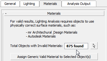

The Lighting Analysis tool requires that all objects in the scene use physically correct surface materials. Only objects assigned the mental ray Arch & Design material or one of the Autodesk Materials (including materials from the Autodesk Material Library) are permitted. All other materials are considered invalid. Objects with no material assigned are also treated as invalid.
The Materials rollout
Total Objects With Invalid Materials box indicates the presence of 875 invalid objects in the scene, which you must now correct.
Locate the objects with invalid materials:
This selects all objects in the scene that have an invalid material. As you can see in the viewports, most of the problem objects are the arena seats.

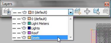

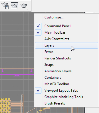

3ds Max opens the Layers toolbar. A layer called Seats has already been created for you.
All seat objects are selected. On the Modify panel, you can see that 874 objects are selected: This is just one object short of the 875 total number of objects with invalid materials.

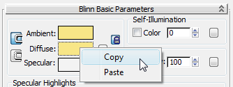

This saves the color for use in the new material you will now apply to the seats.

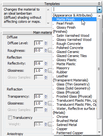

mental ray group. Drag an Arch & Design entry from the Browser into the active View.
This gives the material a neutral reflectivity.

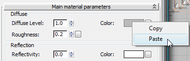

Diffuse group, right-click the Color swatch and choose Paste.
This copies the color from the Standard material to the Arch & Design material.

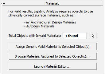

On the Materials rollout, the Total Objects With Invalid Materials field updates to show only one remaining object with an invalid material.
3ds Max selects the Ground object, which is the ground on which the indoor arena stands.
The Ground object has no material assigned to it. If you try to use
(Pick Material from Object), nothing happens. To the Lighting Analysis Assistant, an object with no material assigned is not valid.

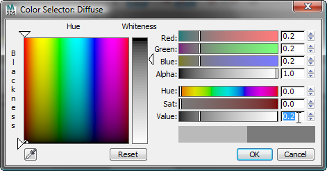

Diffuse group, click the Color swatch.
This gives the material low reflectivity.
Check the Lighting Analysis status again:
Now the status line should display “Status: 0 Invalid Settings.”

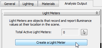

Now that you have set up the scene properly, you can create a Light Meter. For lighting analysis to take place, at least one Light Meter must be present in the scene.
Create a Light Meter:

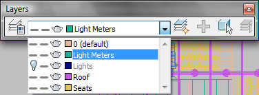

Layers list, choose Light Meters.
Any Light Meter you now create will be added to this layer for easy selection later on.
