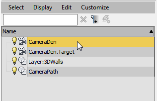

If you don't see the Percent track and its curve, navigate to Objects
CameraDen
Transform
Position
Path Constraint
Percent.

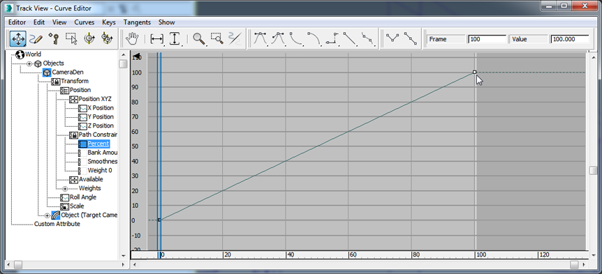

The function curve represents a space-time relationship for the position of CameraDen. It starts at frame 0, 0 percent of the path, and it ends at frame 100, 100 percent of the path (which also is the end of the spline). To change the length of the camera animation, you need to edit the time value of the last keyframe.
The key is represented by a gray square. When you select it, it turns white with a black border.

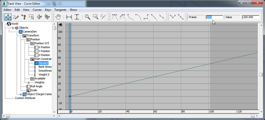

Key Entry : Trackview. The duration of the animation is now set to 200 frames, and the curve now goes off the right end of the window.

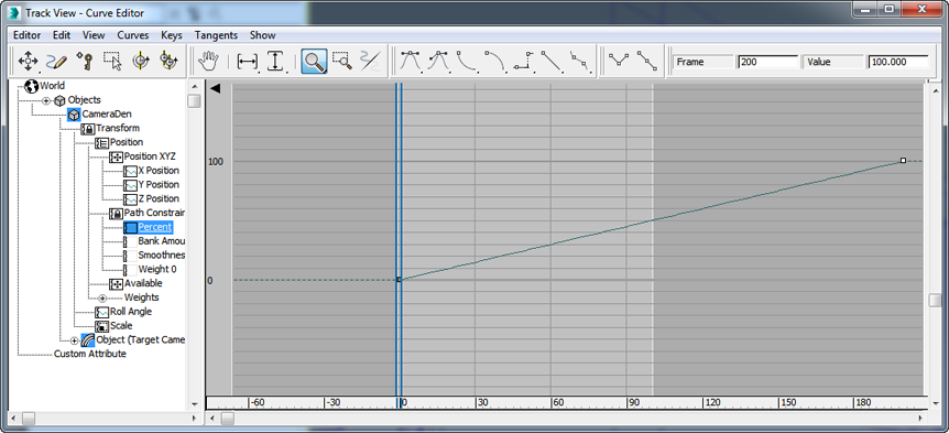

Use the Curve Editor to adjust the camera's speed:
Right now, the camera has a constant speed between frames 0 and 200. This is indicated by the linear “curve” in the curve window. The camera starts suddenly and stops suddenly, which is not typical for real-world movement. It would be more realistic, and more pleasant to viewers' eyes, if the camera began moving slowly, speeded up a bit, and then slowed down before coming to a stop. In animation, the expression for this type of motion is “slow in, slow out.”

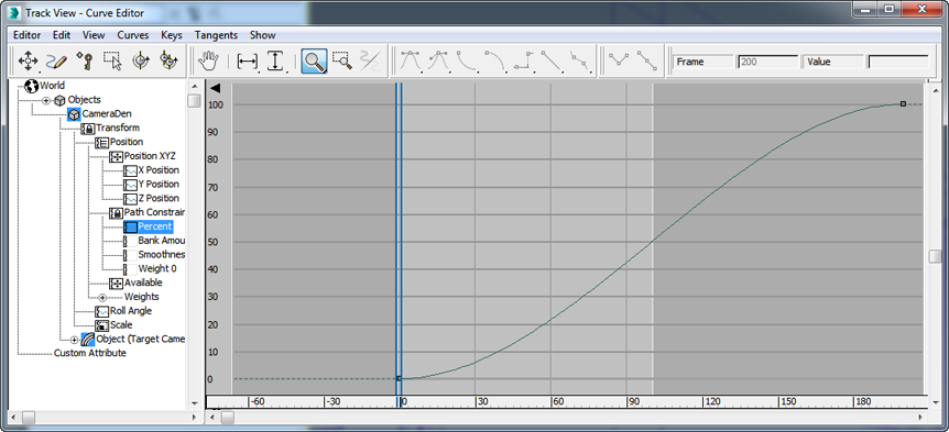

An Assign Float Controller dialog appears.
The Bezier Float controller changes the key tangents so the camera speeds up a bit when it begins to move, and slows down a bit before it stops. The shape of the curve is now a real curve, and indicates the changes in acceleration.

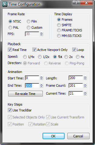

Change the time configuration:
You have changed the keys for the camera to indicate a 200-frame animation, but 3ds Max is still set to render only 100 frames. You also need to change this setting.
3ds Max opens a Time Configuration dialog.

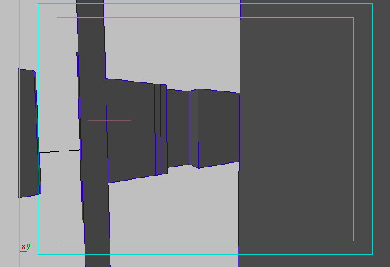

Show safe frames:
Three rectangles appear in the camera viewport. The outer rectangle is the area and aspect ratio of your current display. The middle rectangle is the zone that is safe for action: outside this rectangle, the image might be cut off when displayed on a video screen. The inner rectangle is the zone that is safe for displaying titles such as credits.
