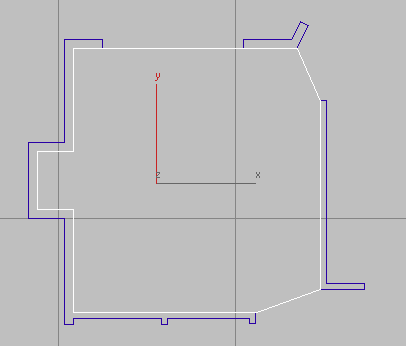

Create a ceiling shape for the den:
- Go to the
Create panel and activate
(Shapes). On the Object Type rollout, click Line to activate it.
- On the Creation Method rollout, choose Corner as both the Initial Type and the Drag Type.
- Starting at the upper-left corner of the den, draw a Line shape that connects the interior vertices of the walls of this room, as shown in the illustration that follows. Proceed in a clockwise direction.
Complete the line by clicking the vertex with which you began the Line. When 3ds Max asks if it should close the spline, click Yes.
- On the main toolbar, click
(3D Snaps Toggle) again to turn it off.
- While the line is still selected, use the Name And Color rollout to rename it Ceiling.
