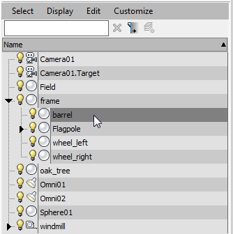

  2. In the Scene Explorer to the left of the viewports, expand the frame entry if you need to, and then click the barrel entry to select the barrel object.

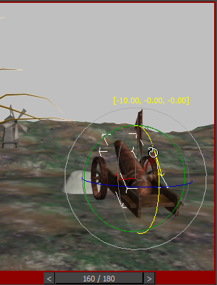

  3. On the main toolbar, click to activate (Select And Rotate).
  4. In the Camera viewport, rotate the barrel on its X axis by –10 degrees.
    As you modify the barrel rotation, the axis values update in yellow.
