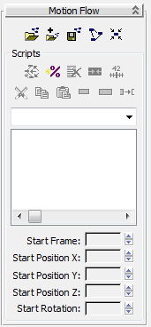

The Motion Flow rollout displays when Motion Flow mode is active on the Biped rollout. You can load, append, and save motion flow editor files (MFE), and open the Motion Flow Graph and Shared Motion Flow dialogs using controls on this rollout.
To load, append, or save a Motion Flow Editor (MFE) file, refer to the following procedures:
Load a Motion Flow Editor file (MFE). Motion Flow Editor files include:
File I/O. If you load an MFE file onto a biped using a shared motion flow, you will get a warning and the biped will be removed from the shared motion flow. The biped will get the newly loaded motion flow and all its scripts.
Append a Motion Flow Editor (MFE) file to the MFE that is already loaded. Displays a load file dialog.
The appended graph will appear directly below the bottom of the existing graph in the graph window, so you may have to scroll down to see it.
Save a Motion Flow Editor (MFE) file.
Saving an MFE file from a biped having a shared motion flow will save the motion flow and its scripts as if it were not shared. It will be a normal MFE file.
Opens the Motion Flow Graph. The first step in script creation is to add clips to the Motion Flow Graph.
Displays the Shared Motion Flows dialog. Allows you to create, delete, and modify shared motion flows. Shared motion flows are used to animate one or more bipeds to simulate a crowd.
If the selected biped is using a shared motion flow, then the icon has a white circle around it.
