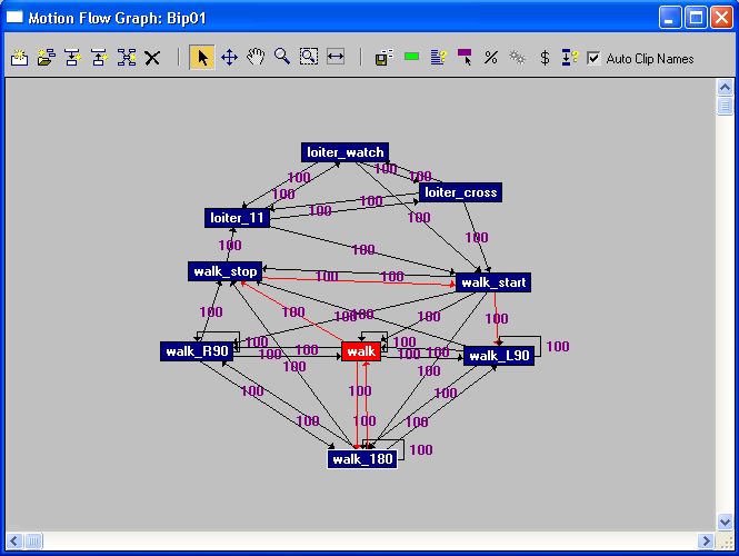

The Motion Flow Graph displays when you click Show Graph on the Motion Flow rollout on the Motion panel.
The first step in Motion Flow mode is to add clips in the Motion Flow Graph for use in scripts. Clips represent all or part of a BIP file. Scripts represent different paths through the clips in the Motion Flow Graph. The first clip in the current script is red. Transitions are shown as arrows between clips, red arrows represent the path through the active script. Black transition arrows indicate unloaded scripts. A transition looping back to the same clip represents a cycle or loop.
If the biped is using a shared motion flow, then the title of the graph window will say "*SHARED* Motion Flow Graph", followed by the name of the shared motion flow. Shared Motion Flows are used to control multiple bipeds with one shared motion flow.
By default, minimum motion loss is used to compute transitions. Optimized transitions use an algorithm that uses minimum foot sliding. Optimized transitions take longer to compute but yield very high quality results.

Displays clip and transition percentages in the Motion Flow Graph window.
Random start clips display in purple and display their probability of starting a random script. This also shows the probability (0–100) that each transition will be chosen. Create Random Motion in the Scripts group uses clip and transition percentages to generate random scripts.
