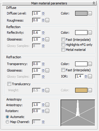

Contains the main controls for the appearance of an Arch & Design material.

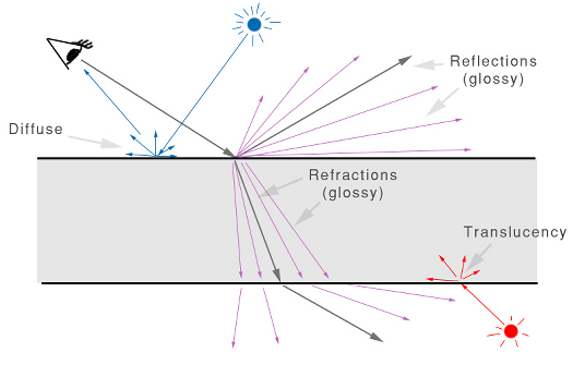

From a usage perspective, the shading model consists of three components:
The Arch & Design material shading model
Direct and indirect light from the scene cause diffuse reflections as well as translucency effects. Direct light sources also create specular highlights.
Ray tracing is used to create reflective and refractive effects, and advanced importance-driven multi-sampling is used to create glossy reflections and refraction.

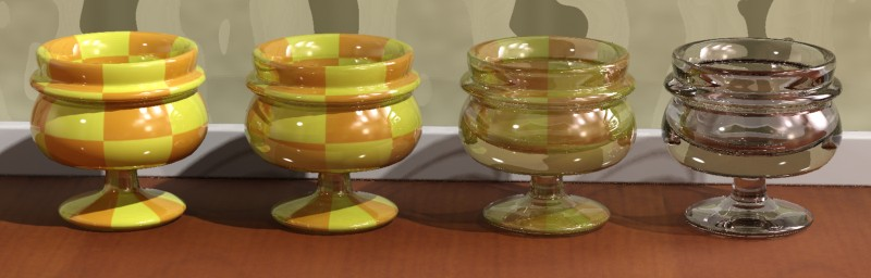

One of the most important features of the Arch & Design material is that it is automatically energy conserving. This means that it makes sure that diffuse + reflection + refraction <= 1. In other words, no energy is “magically” created, and the incoming light energy is properly distributed to the diffuse, reflection, and refraction components in a way that maintains the first law of thermodynamics.
For example, when adding reflectivity, the energy must be taken from somewhere; hence, the diffuse level and the transparency will be automatically reduced accordingly. Similarly, adding transparency happens at the cost of the diffuse level.
The rules are as follows:
From left to right: Reflectivity = 0.0, 0.4, 0.8, and 1.0
From left to right: Transparency = 0.0, 0.4, 0.8, and 1.0

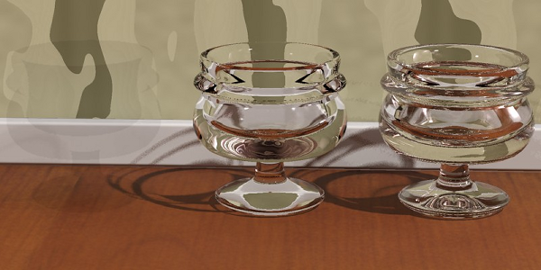

Solid versus thin-walled transparency and translucency
In the preceding illustration, the helicopter canopy, the window pane, the translucent curtain, and the right-hand sphere all use thin-walled transparency or translucency, whereas the glass goblet, the plastic horse, and the left-hand sphere all use solid transparency or translucency.

Click the map button to assign a Diffuse Color map. This button is a shortcut: You can also assign a Diffuse Color map on the General Maps rollout.
The diffuse component uses the Oren-Nayar shading model. When the Roughness value is 0.0, this is identical to classical Lambertian shading; but with higher values, the surface gets a more “powdery” look, as shown in the following illustration.

Click the map button to assign a Diffuse Roughness map. This button is a shortcut: You can also assign a Diffuse Roughness map on the General Maps rollout.
The Reflectivity and Color values combine to define the level of reflections as well as the intensity of the traditional highlight, also known as the specular highlight.

Click the map button to assign a Reflection map. This button is a shortcut: You can also assign a Reflection map on the General Maps rollout.

Click the map button to assign a Glossiness map. This button is a shortcut: You can also assign a Glossiness map on the General Maps rollout.
Available only when Glossiness does not equal 1.0. Because a Glossiness value of 1.0 creates a “perfect mirror,” it is meaningless to shoot multiple rays for this case, hence only one reflection ray is shot.

Click the map button to assign a Refraction map. This button is a shortcut: You can also assign a Refraction map on the General Maps rollout.

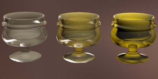

Instead of basing the reflectivity on the IOR, you can instead use the BRDF mode to set it manually:
Different types of transparency
In the previous illustration, the leftmost cup acquires its curve from the index of refraction. The center cup has a manually defined curve, which has been set to a 90-degree reflectivity of 1.0 and a 0 degree reflectivity of 0.2; this looks a bit more like metallized glass. The rightmost cup uses the same BRDF curve, but instead is set to thin-walled transparency. Clearly, this method is better for making non-refractive objects than simply setting IOR to 1.0, as we tried in the left-hand example of the illustration before this one.

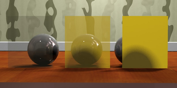

When you turn on Translucency, the Weight and Color settings become available and take effect when rendering.
Weight Determines how much of the existing transparency is used as translucency. For example, if Weight=0.0, all of the transparency is used as translucency. If Weight=0.3, 30 percent of the transparency is used as translucency.
All: Transparency=0.75
Left: Weight=0.0
Center: Weight=0.5
Right: Weight=1.0
Translucency is intended for use primarily in thin-walled mode (as in the example above), to model things like curtains, rice paper, and similar effects. In thin-walled mode it simply allows the shading of the reverse side of the object to bleed through. The shader also operates in solid mode, but, as explained above, the SSS shaders are better suited for such purposes.

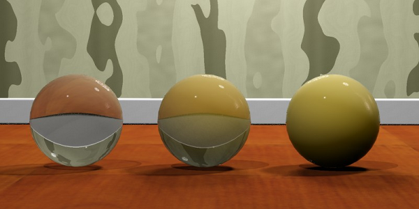

Solid translucency with:
Left: Weight=0.0
Center: Weight=0.5
Right: Weight=1.0
Color The translucency color.
Click the map button to assign a Filter Color map. This button is a shortcut: You can also assign a Filter Color (Translucency) map on the General Maps rollout.
Left: Anisotropy=1.0

Click the map button to assign an Anisotropy map. This button is a shortcut: You can also assign an Anisotropy map on the General Maps rollout.

Click the map button to assign an Orientation (Anisotropy Rotation) map. This button is a shortcut: You can also assign an Orientation (Anisotropy Rotation) map on the General Maps rollout.
When set to Automatic, the base rotation follows the object’s local coordinate system. Alternatively, if you choose Map Channel and set a channel number, the space that defines the stretch directions of the highlights is derived from the specified map channel’s texture space.
