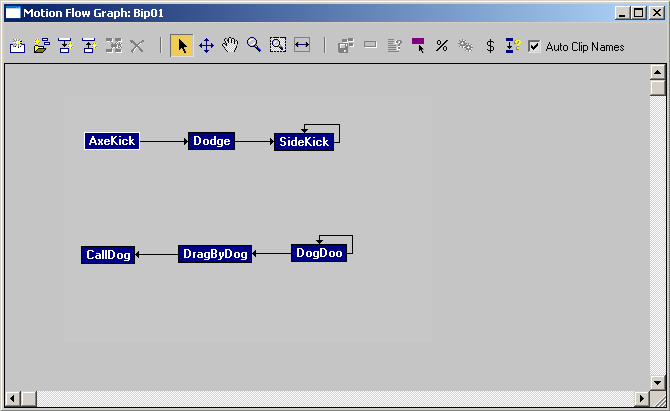

To create transitions using the From > To or To < From method:
Use the file dialog to choose the location of your BIP files.
Once processed, multiple clips appear in Motion Flow Graph.
The top set of clips are linked using Create Transition From->To. The bottom set of clips are linked using Create Transition To<-From.

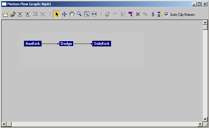

To optimize transitions in the Motion Flow Graph:
Selected transitions display in white
The Transition Optimization dialog is displayed.
While the optimizations are being processed, a processing bar scrolls across the top of the Motion Flow Graph window.
